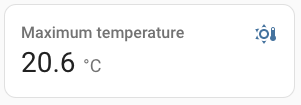

Screenshot of the statistic card for a temperature sensor.
