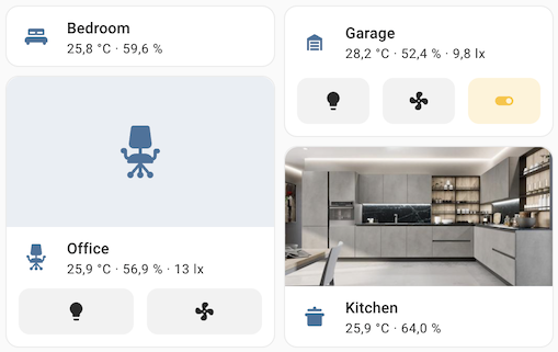

The area card lets you control and monitor an individual area.
Screenshot of the area card Screenshot of the area card.

Buttons will appear on the card for the entities in the area including fan, light and switch. A motion sensor icon will appear in the top left if a motion sensor is in the area and motion is detected by the motion sensor.
If a camera is added to the area you can show the camera feed instead of the area picture.
