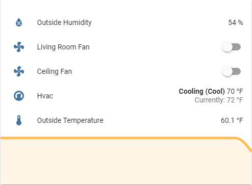

Graph header & footer
Widget to show an entity in the sensor domain as a graph in the header or footer.
Screenshot of an entities card with a graph footer.
footer:
type: graph
entity: sensor.outside_temperature
hours_to_show: 24
detail: 1
