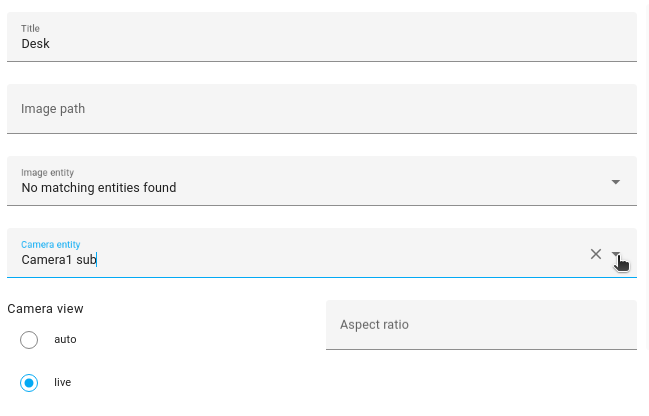

Select your camera entity.
Image path and Image entity are not required.

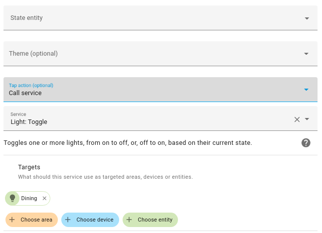

If you want something to happen when you tap the card itself, define a tap action.
- Here, we toggle a light.

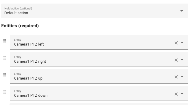

Select the entities to move the camera left, right, up, or down.
Select Show code editor.
For each of the entities, specify an icon, as indicated in the YAML example.
For the buttons to react on press (instead of bringing up the dialog):
- For each of the entities, under
tap_action, use abutton.pressaction.
camera_view: live type: picture-glance title: Desk entities: - entity: button.camera1_ptz_left icon: mdi:pan-left tap_action: action: perform-action perform_action: button.press data: entity_id: button.camera1_ptz_left - entity: button.camera1_ptz_right icon: mdi:pan-right tap_action: action: perform-action perform_action: button.press data: entity_id: button.camera1_ptz_right - entity: button.camera1_ptz_up icon: mdi:pan-up tap_action: action: perform-action perform_action: button.press data: entity_id: button.camera1_ptz_up - entity: button.camera1_ptz_down icon: mdi:pan-down tap_action: action: perform-action perform_action: button.press data: entity_id: button.camera1_ptz_down camera_image: camera.camera1_sub tap_action: action: perform-action perform_action: light.toggle target: entity_id: light.philips_929003052501_01_huelight - For each of the entities, under
