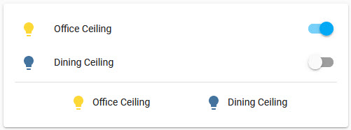

Buttons row
Above the divider are regular entity rows, below one of type buttons
. Note that regular entity rows automatically show the entity name, whereas for buttons you have to explicitly specify a label / name.
Screenshot of buttons row.
type: entities
entities:
- entity: light.office_ceiling
- entity: light.dining_ceiling
- type: divider
- type: buttons
entities:
