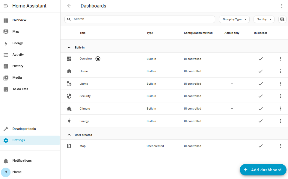

Under Settings > Dashboards, you can see your own dashboards as well as the predefined, built-in dashboards.
Screenshot of the dashboard list Screenshot of the Dashboard list.

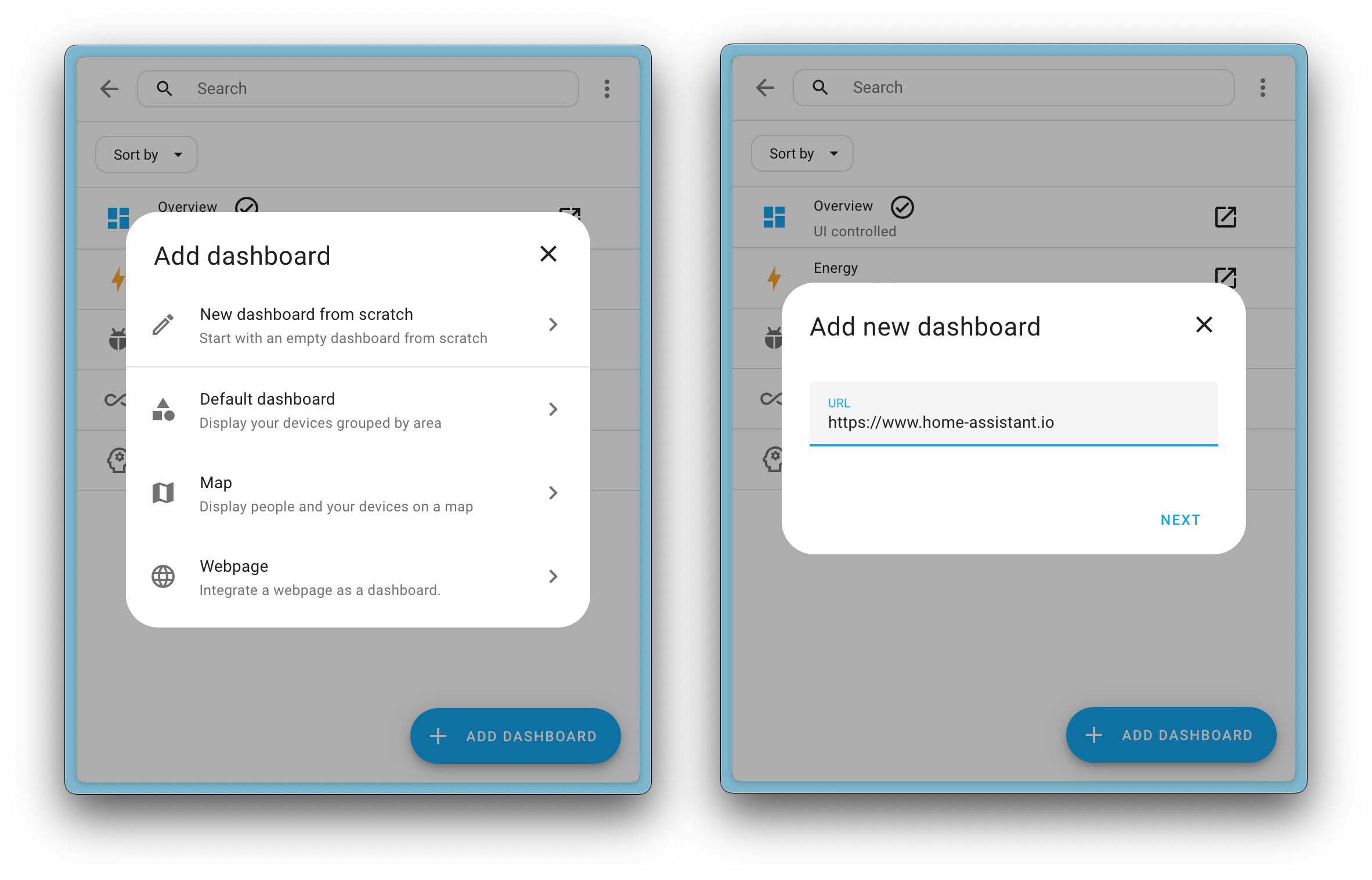

Webpage dashboard
Another available (but not default) dashboard is the webpage dashboard. The webpage dashboard allows you to add and embed a webpage to your dashboard. This could be a web page from the internet or a local web page from a local machine or device like your router or NAS. The webpage dashboard uses the webpage card.

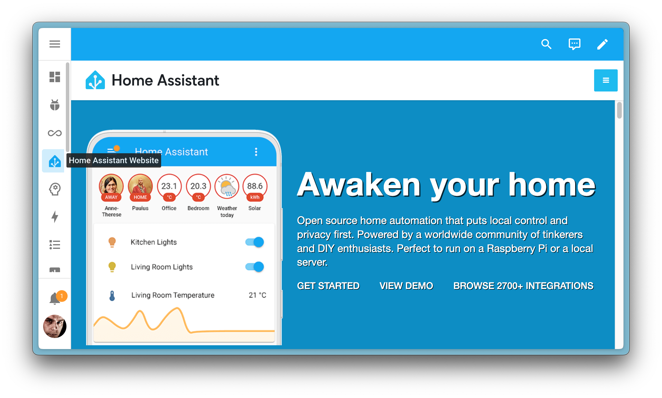

Screenshots showing addition of a new webpage dashboard to Home Assistant, embedding the Home Assistant website.
This dashboard replaces the old iFrame panel (iframe_panel). If you have existing panels configured in your YAML configuration, Home Assistant will automatically migrate them to the new webpage dashboard on upgrade.
Screenshot showing the Home Assistant website embedded into the Home Assistant frontend using a webpage dashboard.
Note that not every webpage can be embedded due to security restrictions that some sites have in place. These restrictions are enforced by your browser and prevent embedding them into a Home Assistant dashboard.

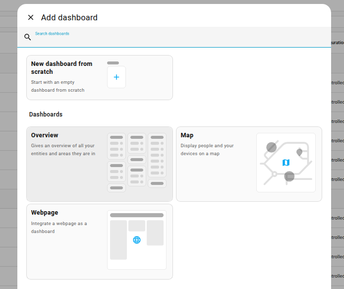

  1. Go to Settings > Dashboards.
  2. Select Add dashboard.
  3. In the dialog, choose one of the options:
    • If you want to start with a pre-populated dashboard, choose Overview or one of the suggested ones, such as the Map dashboard.
    • If you want to start with a completely empty dashboard, choose New dashboard from scratch. Screenshot of the Add Dashboard dialog showing dashboard options like Overview, Map, and Areas
