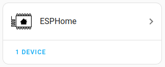

You should now see the ESPHome integration.

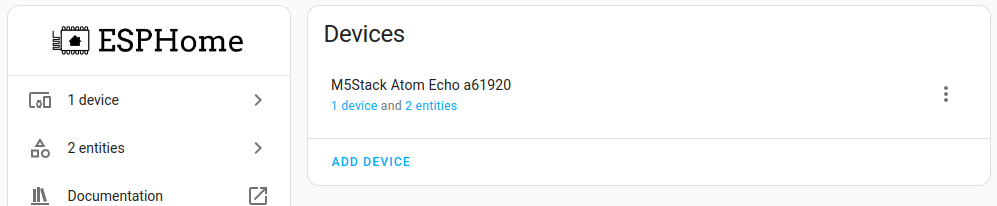

Select the ESPHome integration. Under Devices, you should see the M5Stack Atom Echo listed.
- Your ATOM Echo is connected to Home Assistant over Wi-Fi. You can now move it to any place in your home with a USB power supply.

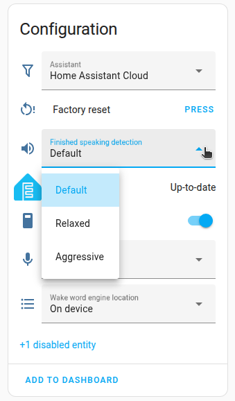

- You find ATOM Echo takes too long to start processing your command?
- Adjust the silence detection settings. This setting defines how much silence is needed for Assist to find you’re done speaking and it can start processing your command.
- Go to Settings > Devices & Services and select the ESPHome integration.
- Under M5Stack ATOM Echo, select 1 device.
