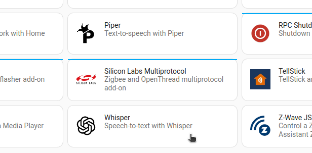

Install the add-ons to convert text into speech and vice versa.
- Install the Whisper and the Piper add-ons.
- If you want to use a wake word, also install the openWakeWord add-on.
- Start the add-ons.

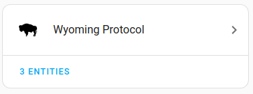

- Once the add-ons are started, head over to the integrations under Settings > Devices & Services.
- You should now see Piper and Whisper being discovered by the Wyoming integration.
- For each integration, select Configure.
Once the setup is complete, you should see both Piper and Whisper (and, optionally, also openWakeword) in one integration.
- Whisper converts speech into text.
- Piper converts text into speech.
- Wyoming is the protocol they are both using to communicate.

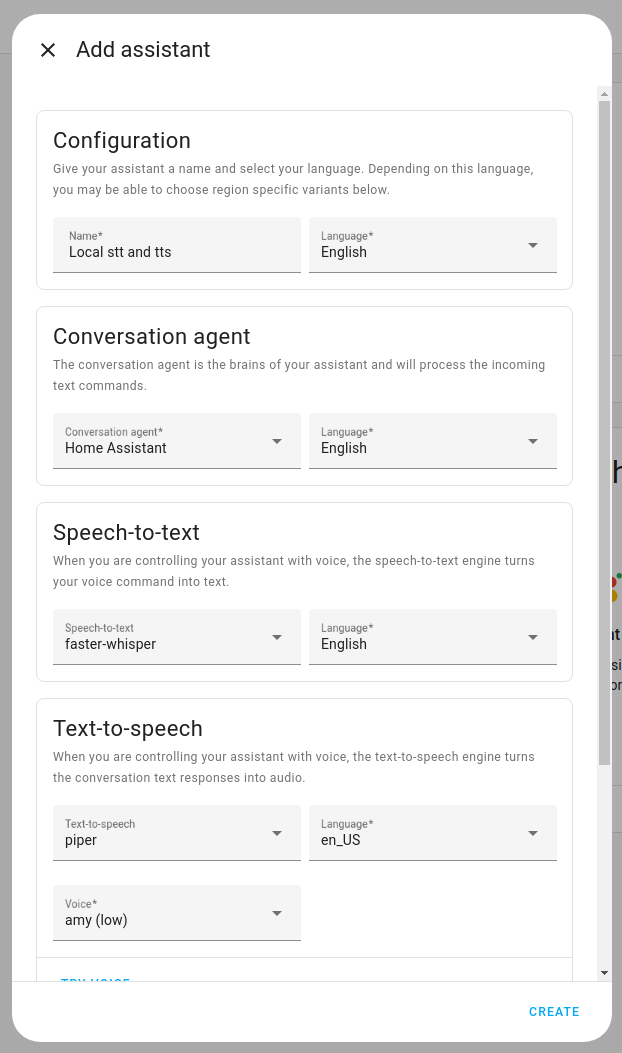

Go to Settings > Voice assistants and select Add assistant.
Troubleshooting: If you do not see any assistants here, you are not using the default configuration. In this case, you need to add the following to your configuration.yamlThe configuration.yaml file is the main configuration file for Home Assistant. It lists the integrations to be loaded and their specific configurations. In some cases, the configuration needs to be edited manually directly in the configuration.yaml file. Most integrations can be configured in the UI.[Learn more] file:
# Example configuration.yaml entry assist_pipeline:
Enter a name. You can pick any name that is meaningful to you.
Select the language that you want to speak.
Under Conversation agent, select Home Assistant.
Under Speech-to-text, select faster-whisper. Select the language.
Under Text-to-speech, select piper. Select the language.
- Depending on your language, you may be able to select different language variants.
If you like, pick one of the predefined wake words.
- You can even define your own wake word. This is not difficult to do, but you will need to set aside a bit of time for this.
- Once you defined your own wake word, it will show in this pick list.
That’s it. You ensured your voice commands can be processed locally on your device.
