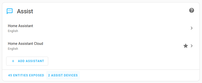

  3. To view the settings, go to Settings > Voice assistants and under Assist, select Home Assistant Cloud. Select the Home Assistant Cloud voice assistant
    • Troubleshooting: If you do not see any assistants here, you are not using the default configuration. In this case, you need to add the following to your configuration.yaml file:
