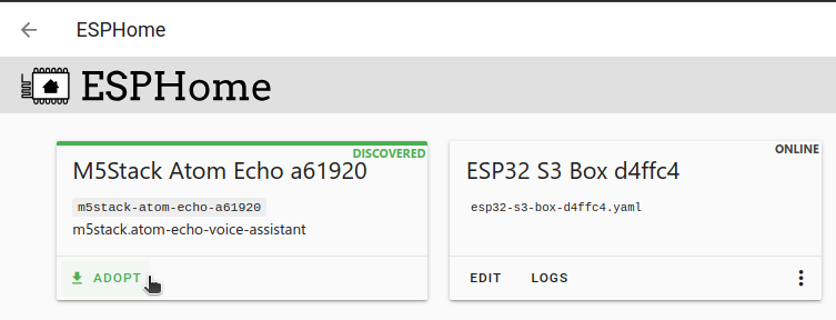

    • Option 1: You do not have the ESPHome add-on installed or you have the add-on but did not adopt the ESP32-S3-BOX-3. If the device is shown in green, it is not adopted. ESP32-S3-BOX-3 not adopted
      1. Make sure the USB cable is plugged into the ESP32-S3-BOX-3.
      2. Go to the ESPHome projects website, select the Connect button, then Change Wi-Fi.
    • Option 2: You already have the ESPHome add-on installed and adopted the ESP32-S3-BOX-3 on your ESPHome dashboard.

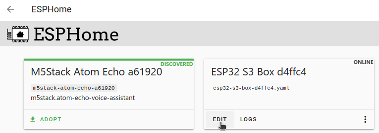

      2. In Home Assistant, go to Settings > Add-ons > ESPHome, and Open Web UI.

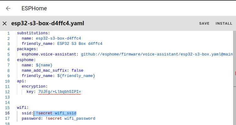

      3. On the ESP32-S3-BOX-3 add-on, select edit. ESP32-S3-BOX-3 open config file
        • Result: An editor opens, showing the configuration file. ESP32-S3-BOX-3 edit config file
      4. In the wifi section, check if it refers to the secrets file (contains !secret). If it does not contain a wifi section, enter the section below:

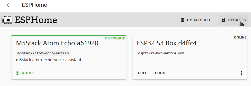

      5. Close the editor and in the overview, select Secrets. ESP32-S3-BOX-3 open config file

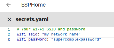

      6. Enter your Wi-Fi credentials. ESP32-S3-BOX-3 open config file

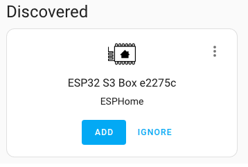

  3. Go to Settings > Devices & Services.
  4. If you see the screen below, but the ESP32-S3-BOX-3 is not listed, select Setup another instance of ESPHome.
    • Go to your router, find the IP address or hostname of your device, and enter it.
