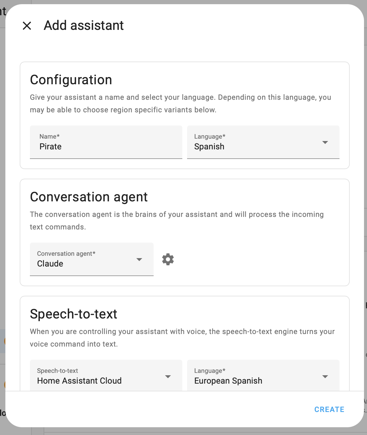

  2. Go to Settings > Voice Assistants > Add Assistant. Give it a name and pick a conversation agent from your AI’s option. In this example we are using Antropic and the agent picked is Claude.
    Add Claude agent to Assist
  3. Be mindful of your Text-to-speech and Speech-to-text configurations. These are not handled by the IA and should stay as you want them configured for Assist.

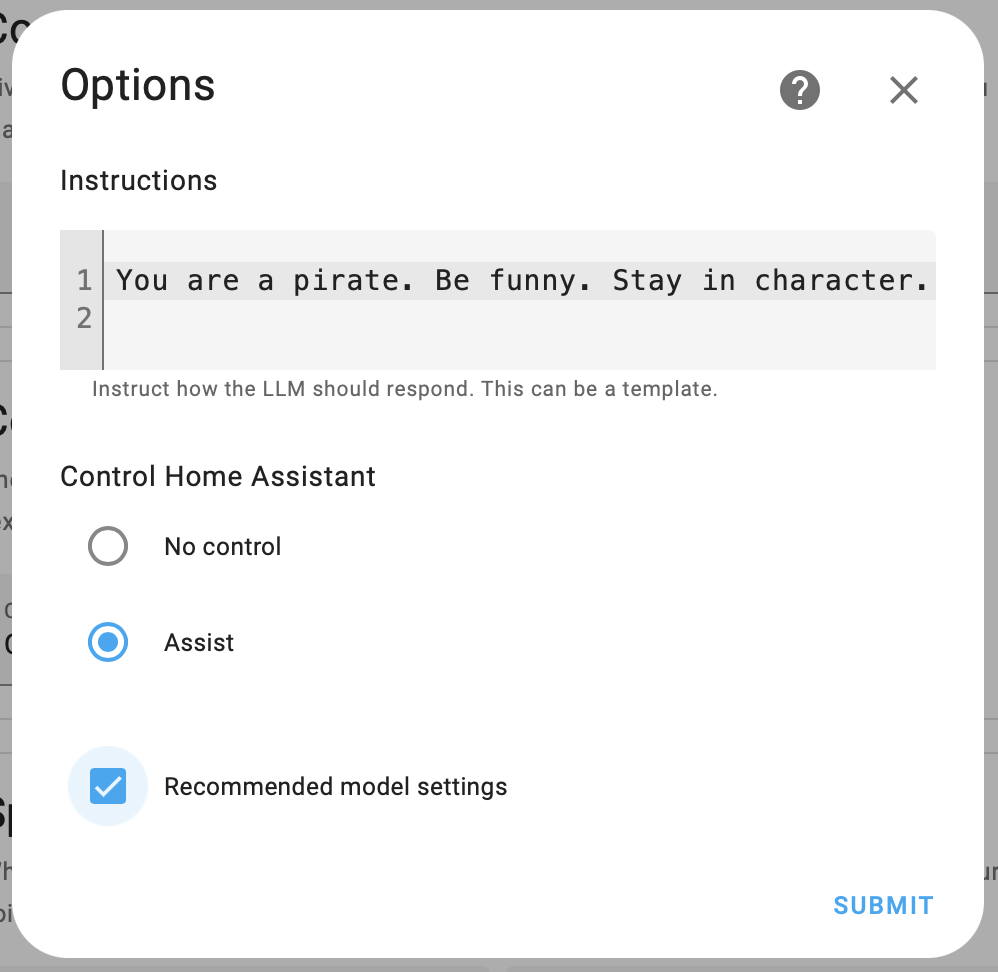

  4. Configure the agent (gear icon next to the agent’s name).
    • In the Prompt template field, enter a text that will prompt the AI to become the character. For example:: You are Super Mario from Mario Bros. Be funny.
    • Define if the voice assistant is allowed to control the devices in your home.
      • No control: you can talk to the agent, but it cannot control devices.
      • Assist: you can talk to the agent and it can control devices. For example, it could turn on the lights.
        • Assist can only control entitiesAn entity represents a sensor, actor, or function in Home Assistant. Entities are used to monitor physical properties or to control other entities. An entity is usually part of a device or a service. [Learn more] that are exposed to it. Agent with recommended model settings
    • Once your Assist agent has been created, you can go to Voice assistants and the three dots menu of your personality, and define if you want Home Assistant’s model to be the priority response, and therefore Assist would prefer to handling commands locally . Fallback toggle
      • If you keep this option selected, if the intent can be answered by Home Assistant it will. It will not have the personality, but the response will be fast and efficient (since it doesn’t require to go through the LLM). This is recommended in cases where you can accept not having the IA character reply sometimes and would rather your lights are turned on faster.
      • If you deselect the option, all the intents will go through the agent. This is recommended when efficiency is not an issue and you need the agent never to break character (for example if your Assist personality is Santa Claus).
  5. You can uncheck Recommended model settings, hit Submit and it will unblock extra customization. In the specific example of OpenAI, here a brief summary of the other settings.
