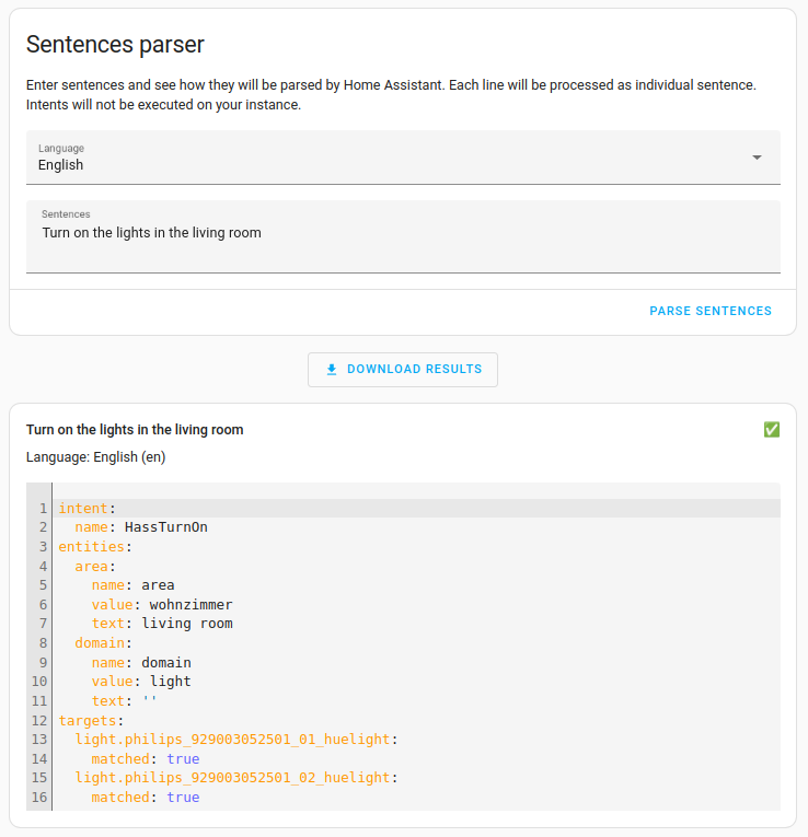

If you want to test if a sentence works in a specific language without actually executing the commands, use the sentence parser in Tools.
  1. Go to Settings > Tools > Assist.
  2. In the sentence parser, select the language and enter the sentence you want to test.
  3. The debug tool shows you the following:
    • The intent triggered.
    • The entities that were targeted.
    • Which of the targeted entities were matched. Open the Assist developer tool sentence parser

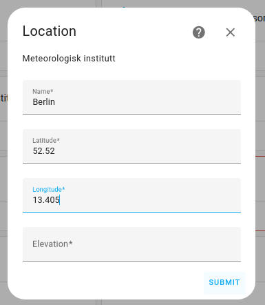

  2. Make sure you have an entity set up for the location you are interested in.
    • For example, if you are interested in the weather in Berlin, add an entity for Berlin.
      Create weather entity

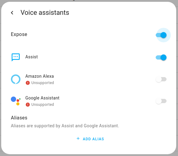

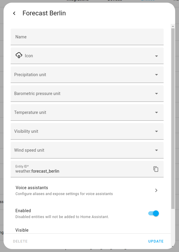

  3. Make sure the entity is exposed to Assist:
    • Under Settings > Devices & services > Entities, select the weather entity for that location.
    • In the details view that opens, select the cogwheel , then select Voice Assistant.
      Select voice assistants
    • Make sure the entity is exposed to Assist.
      Expose entity to Assist

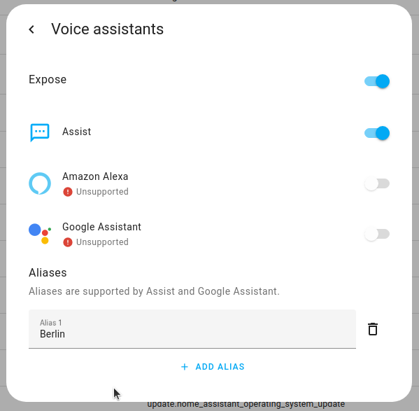

    • If you want to use Berlin instead of Forecast Berlin, you can create an entity name alias.
      • You can create as many aliases as you like.
      Create alias for entity name
