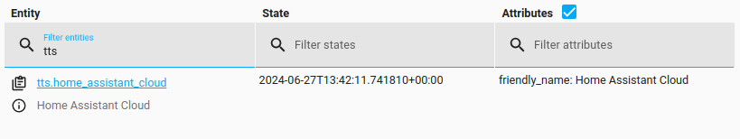

The state of a text-to-speech entity
The state of a text-to-speech entityAn entity represents a sensor, actor, or function in Home Assistant. Entities are used to monitor physical properties or to control other entities. An entity is usually part of a device or a service. [Learn more] is a timestamp showing the date and time when text-to-speech was last used.
Screenshot showing the state of a text-to-speech entity in the developer tools Screenshot showing the state of a text-to-speech entity in the developer tools.
