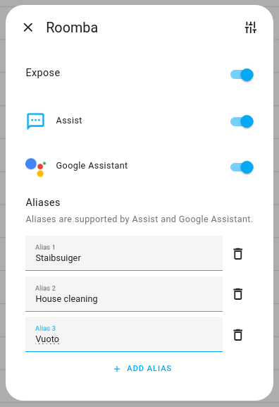

Adding an alias of an entity
There are multliple ways to add an alias of an entity:

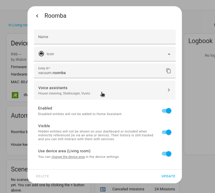

  • Option 1: Go to Settings > Voice assistants. On the Expose tab, select the entity for which you want to add an alias. Screenshot showing the alias editing capabilities added to the more info dialog of entities, accessed from the Voice assistants page
  • Option 2: You can also change the alias from the entity’s more information dialog in the settings tab in the advanced section. Screenshot showing the alias editing capabilities added to the more info dialog of entities, accessed from the Voice assistants page.
