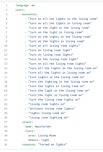

Take a look at the test sentences:
On GitHub, in the tests folder, open the subfolder for your language.
Look through the test files to see the example sentences that have been tested.
The second part of the file name shows the intentIntent is a term used with voice assistants. The intent is what Home Assistant thinks you want it to do when it extracts a command from your voice or text utterance.
[Learn more], the first part shows the domainEach integration in Home Assistant has a unique identifier: The domain. It is often shown as the first part (before the dot) of entity IDs. . For some domainsEach integration in Home Assistant has a unique identifier: The domain. It is often shown as the first part (before the dot) of entity IDs. , such as covers, fans, and light, there are specific sentences. The other domainsEach integration in Home Assistant has a unique identifier: The domain. It is often shown as the first part (before the dot) of entity IDs. are covered by the generic homeassistant_. -
The screenshot below shows sentences used to test the command to turn on the lights. Note that Living room here is just a place holder. It could be any areaAn area in Home Assistant is a logical grouping of devices and entities that are meant to match areas (or rooms) in the physical world: your home. For example, the
living room
area groups devices and entities in your living room. that you have in your home.
