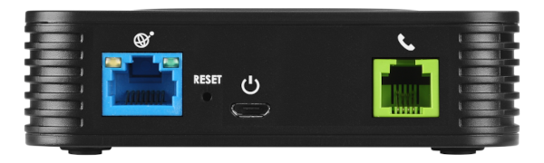

  1. Connect the RJ11 cable from the phone to the green socket on the Grandstream. Grandstream HT801 ports
  2. Connect the Grandstream to your network:
    • Plug the Ethernet cable into the blue socket and connect it to your router.

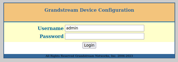

  5. Enter the IP address into a browser window and log onto the Grandstream Device Configuration software.
    • The default credentials are:
      • Username: admin
      • Password: admin
        Login to Grandstream

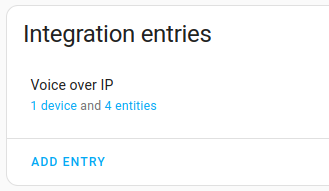

  1. In Home Assistant, go to Settings > Devices & Services > Add integration and add the Voice over IP integration. Voice over IP integration
  2. Once you see the integration, pick up the phone.
    • You should now hear the message This is your smart home speaking. Your phone is connected, but you must configure it within Home Assistant.
    • The integration should now include a device and entities. Voice over IP integration with device and entities

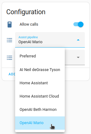

  1. Create a Mario personality.
  2. In the Voice over IP integration, under Configuration, select the Mario assistant you just created.
    VoIP: select OpenAI
  3. That’s it! Pick up your phone and ask Mario a question.

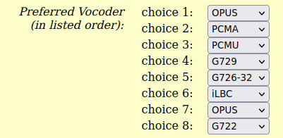

  1. On the FXS Port tab, check the Preferred Vocoder list.
    • Make sure that OPUS is selected for one of the choices: Vocoder OPUS option
  2. Under OPUS Payload type, make sure the value is 123. It’s the default option. Vocoder OPUS payload type
  3. At the bottom of the page, select Apply.
  4. Pick up the phone again and check if you hear the voice.

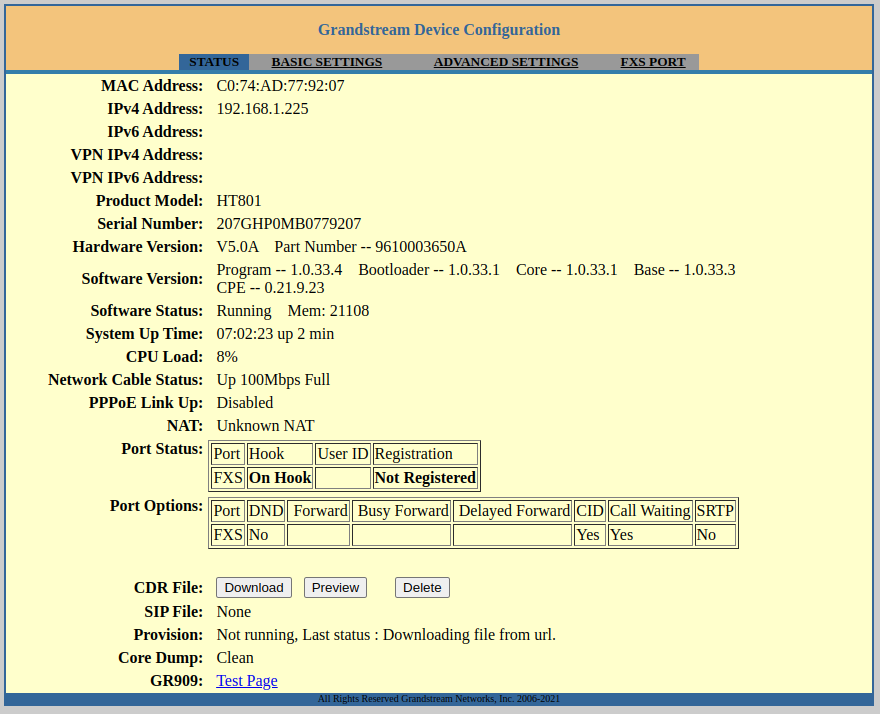

The Voice over IP integration no longer works
Symptom You were able to control Home Assistant over the phone but it no longer works. When picking up the phone, no sound is played. The debug information shows no runs.
Potential remedy
  1. Log onto the Grandstream Device Configuration software.
  2. On the Status page, check if the Hook status changes from On Hook to In Use after you picked up the phone. Check the Grandstream status
    • The software is quite slow. Refresh the page and wait for a while before hanging up again.
  3. If the status does not change, reboot the Grandstream and try calling Home Assistant again.
