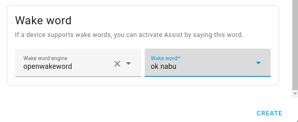

If you like, pick one of the predefined wake words.
- You can even define your own a wake word. This is not difficult to do, but you will need to set aside a bit of time for this.
- Once you defined your own wake word, it will show in this pick list.
