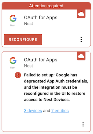

Important: Remove existing Google credentials first
If you have previously set up the Google integration or a Nest integration, you should remove any existing Google integration credentials before proceeding.
To remove existing credentials:
  1. Go to Settings > Devices & services.
  2. Select the three dots (⋮) menu in the upper right corner.
  3. Review the list for any previous Google or Nest integrations.
  4. Remove any existing Google/Nest integration by selecting it and choosing “Delete”.
This ensures that Home Assistant will use your latest Google integration configuration and prevents authentication conflicts.

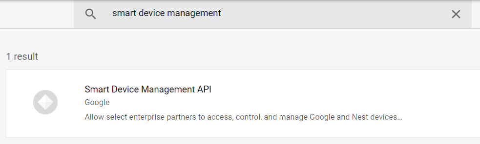

  6. From the API Library search for Smart Device management and click Enable.

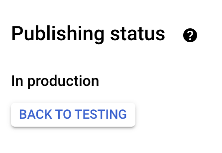

  5. Still on the Audience page, under Publishing status, click Publish app to set the status to In production.
    Make sure the status is not Testing, or you will get logged out every 7 days.
    The warning says your app will be available to any user with a Google Account. This refers to the fields you entered on the Branding page if someone finds the URL. This does not expose your Google Account or Nest data.

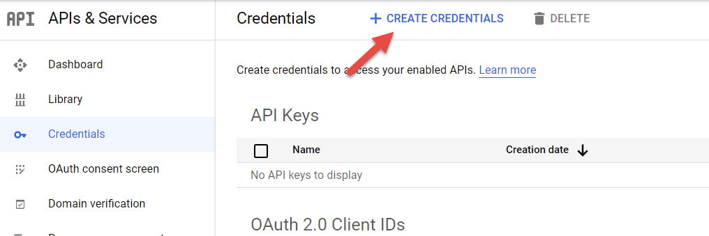

  1. Navigate to the Credentials page and click Create Credentials. Screenshot of APIs and Services Cloud Console

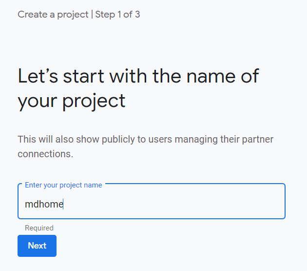

  4. Give your Device Access project a name and select Next. Screenshot of naming a project

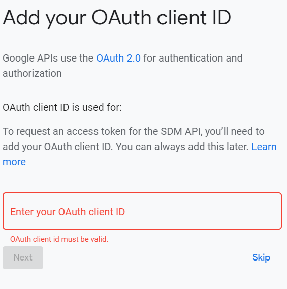

  5. Next you will be asked for an OAuth client ID which you created in the previous step and select Next. Screenshot of Device Access Console OAuth client ID

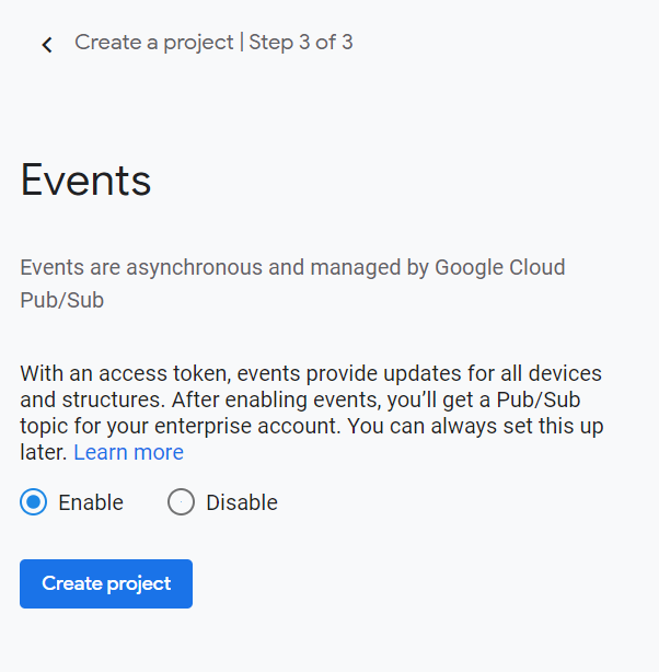

  6. Leave Enable Events unchecked for now and Create project. You need a Pub/Sub topic (created in the next section) to enable events. This requires additional setup in the Google Cloud Pub/Sub console so we will skip that step for now then come back to it in the next section.

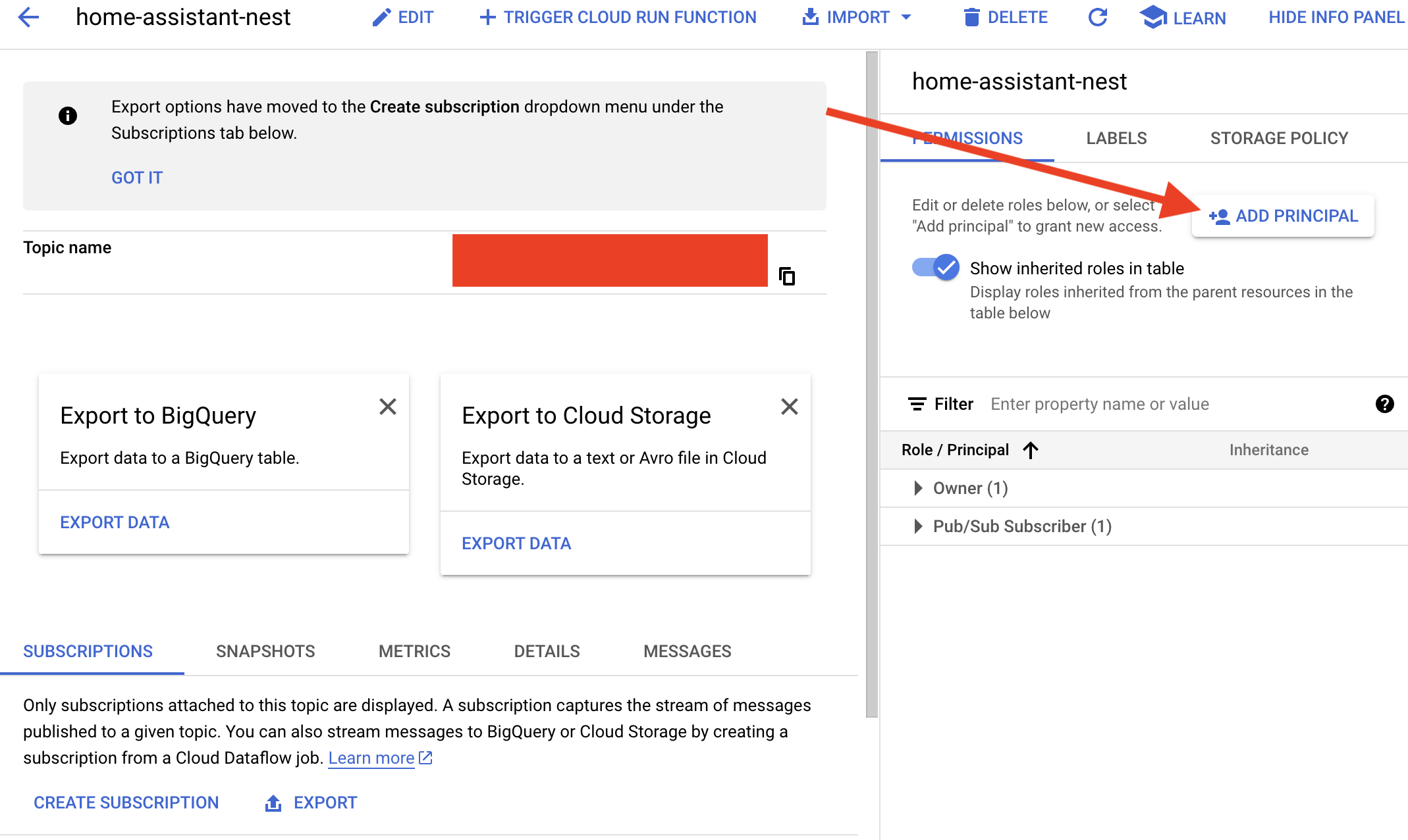

  2. You now have a Topic Name needed by the Device Access Console and Home Assistant. The full Topic Name that contains your Cloud Project ID and the Topic ID such as projects/<cloud console id>/topics/home-assistant-nest.
  3. Next, you need to give the Device Access Console permission to publish to your topic. From the Pub/Sub topic list, select the topic you just created to open it, then open the Permissions tab and select Add principal.
Screenshot of adding a principal to a Pub/Sub topic
  1. In New principals, enter [email protected].
  2. In the Assign roles section, select the Role dropdown. Under Pub/Sub, select Pub/Sub Publisher (or type Pub/Sub Publisher in the search box to find it). Select Save.

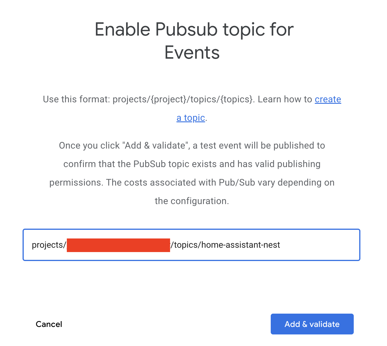

  1. Next you can configure the Device Access Console to use this topic. Visit the Device Access Console.

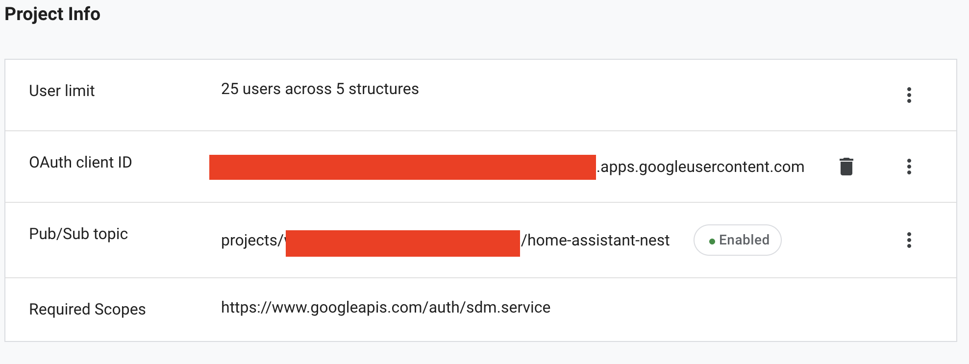

  2. Select the Device Access Project you previously created. It should show the Pub/Sub topic as disabled. If there is an existing topic shown, then you may delete it and use the one you just created to avoid getting them mixed up.
Screenshot of OAuth confirmation
  1. Select … next to Pub/Sub topic, then Enable events with PubSub topic.
  2. Enter the full Pub/Sub Topic Name and select Add & Validate. If you see an error, then review the previous steps again and configure the topic and permissions.
  1. You have successfully configured events and the Pub/Sub topic used by Home Assistant.

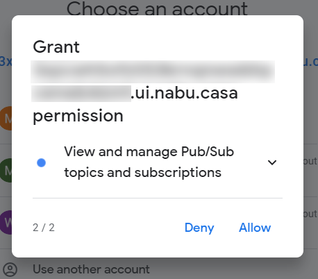

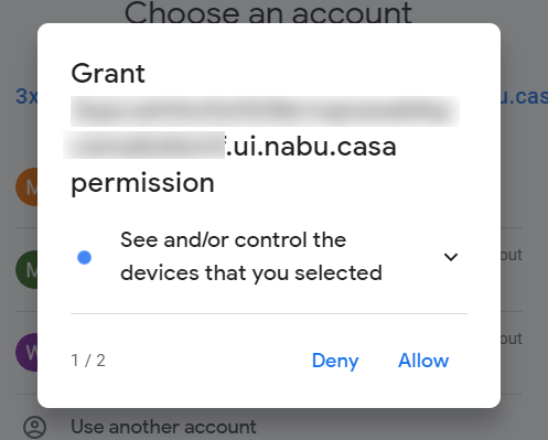

Link Google Account
In this section you will authorize Home Assistant to access your account by generating an Authentication Token.
See Troubleshooting below for steps to resolve the common misconfigurations that result in errors such as Can’t link… or Error 400 from Google.
  1. In Home Assistant, you should already be going through the setup flow. If not, go back and click the My: Add Integration button above to start the setup. The integration will ask you for all of the necessary integration configuration.
  2. Once all configuration information is entered in Home Assistant, a new tab opens, allowing you to choose a Google account. This should be the same developer account you configured above.
  3. The Google Nest permissions screen will allow you to choose which devices to configure and lets you select devices from multiple homes. You likely want to enable everything, however, you can leave out any feature you do not wish to use with Home Assistant.
    Screenshot of Nest permissions authorization
  4. You will get redirected to another account selection page.
  5. You may see a warning screen that says Google hasn’t verified this app since you set up an unverified developer project. Select Advanced, then select Go to home-assistant.io (unsafe) to proceed.
    Screenshot of OAuth warning
  6. Review the access Home Assistant is requesting, then select Continue to allow it to access your Google Account.
    Screenshot of granting access to your Google Account

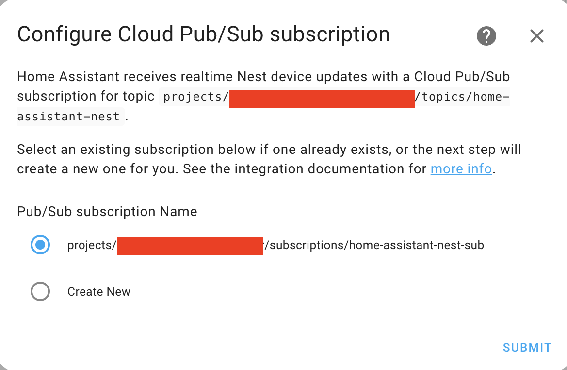

  8. If all went well, you will next configure events and a Pub/Sub topic. Select an existing Pub/Sub topic from your Google Cloud project, or select Create new topic to have Home Assistant automatically create one and grant [email protected] permission to publish to it.
    Screenshot of the Pub/Sub topic selection
  9. Confirm that the Device Access Console is configured with the selected Pub/Sub Topic Name (follow steps 9–13 in Enable events and Pub/Sub topic above to enable events with this topic name in the Device Access Console if you have not already done so), then select Submit to continue.
  10. Home Assistant uses a Subscription to subscribe to device events published on the topic. Select Create new subscription for Home Assistant to create one automatically, or select an existing subscription for the topic. Screenshot of the Pub/Sub subscription selection

  • This should show the redirect URI https://my.home-assistant.io/redirect/oauth in the error message. If the error message has a different URL, then you are running an older version of Home Assistant need to upgrade or manually disabled My Home Assistant (see below).
    Screenshot of success
  • Go back to the API Console and select your OAuth 2.0 Client ID.
  • Add the URL https://my.home-assistant.io/redirect/oauth to the list of Authorized redirect URIs and click Save and start the flow over.

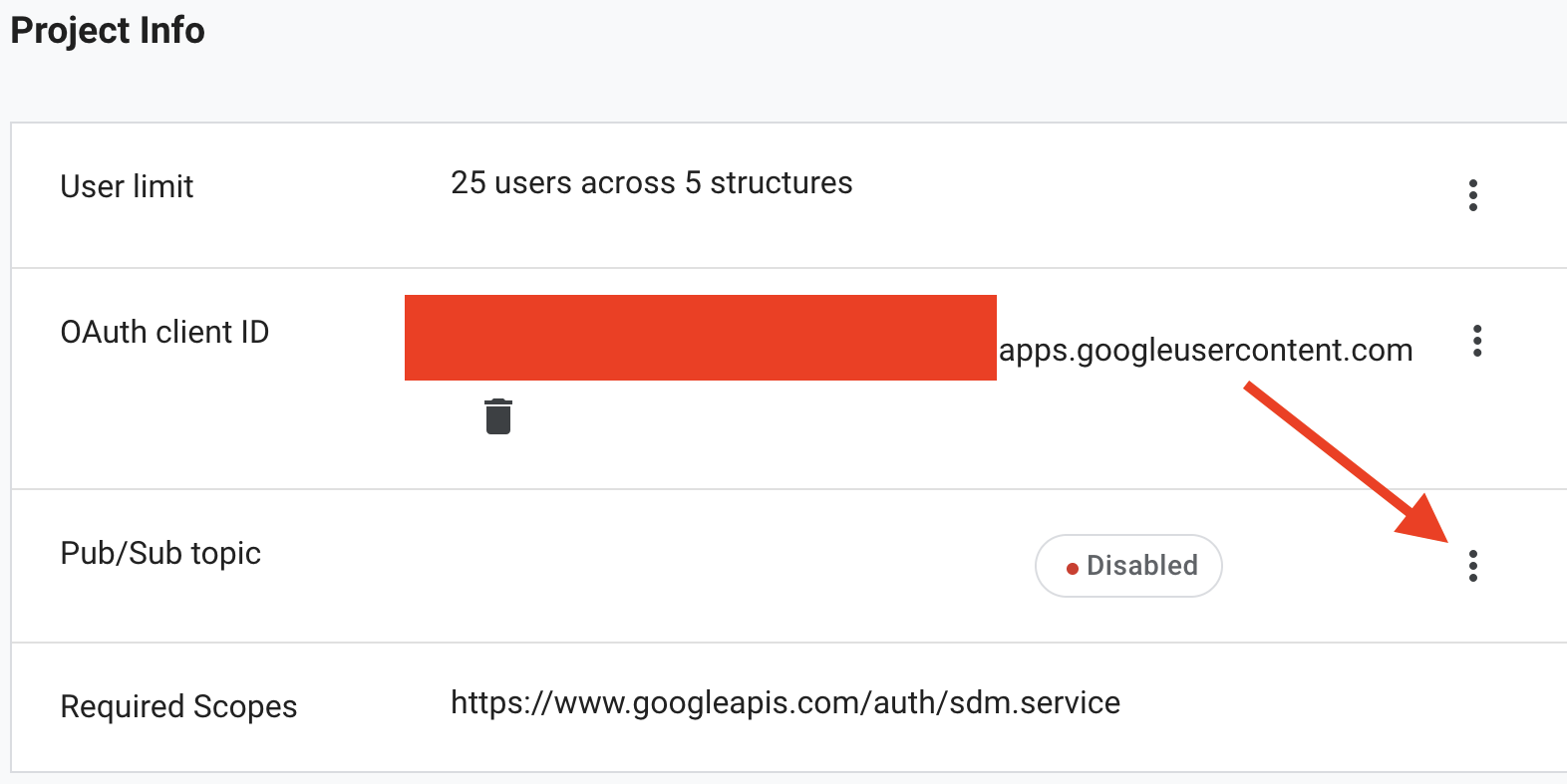

Symptom: Configuration error: Failed to create subscriber subscription/name was not found
Description
The integration fails to start because it attempts to create a subscriber with a subscription name that is not found in your Google Account. By default, Google pub/sub subscriptions will be deleted after 31 days of inactivity (reference). If this happens, then the integration will fail, and you will see the preceding log line in your Home Assistant logs.
Resolution.
To repair the subscriber:
  1. Go to the Device Access Console and verify the Pub/Sub topic is enabled.
  2. In Home Assistant, go to Settings > Devices & services > Nest, open the integration entry menu, and select Reconfigure to select or create a Pub/Sub topic and subscription.
  3. (Optional) To prevent future expirations, go to your Google Cloud Console Pub/Sub subscription page and edit the Pub/Sub subscription created by Nest to not expire by default.

  • Verify the Nest Device Access Console configuration
    1. Visit the Device Access Console
    2. Click the Home Assistant device access project
    3. Verify the Pub/Sub topic is Enabled. If not, follow the integration configuration instructions.
    4. If the Pub/Sub topic starts with projects/<your cloud project>/topics/home-assistant- then you are using a topic created by Home Assistant. You may follow the steps in the next section to verify the topic.
    5. If the Pub/Sub topic starts with projects/sdm-prod/topics, you are using a legacy Google-hosted topic. Google will stop publishing events to these topics on November 30, 2026. To migrate, go to Settings > Devices & services > Nest, open the integration entry menu, and select Reconfigure. Select Create new topic (or choose an existing topic in your Google Cloud project), then follow the on-screen instructions to disable the legacy topic and enable events with the new topic in the Device Access Console before creating a new subscription. For more information, refer to Google’s event migration instructions.
