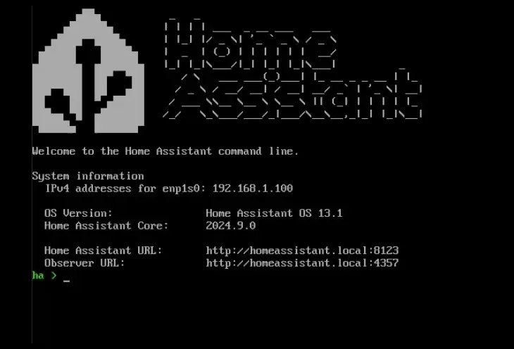

- Once you have opened the Home Assistant command line, enter the following command:
Command:
auth reset --interactive - This will display a list of users. Select your user and enter a new password when prompted.
- Troubleshooting: If you see the message
zsh: command not found: auth, you likely did not enter the command in the serial console connected to the device itself, but in the terminal within Home Assistant.
Command:
- You can now log in to Home Assistant using this new password.

Once you’re connected, you’ll see a running dmesg log. Hit the enter key to interrupt the log. Sign in as “root”. There is no password.
You will then be at the Home Assistant CLI, where you can run the custom commands. These are the same as you would run using the SSH app but without using ha in front of it. For example:
core logsfor Home Assistant Core log -
supervisor logsfor supervisor logs -
host rebootto reboot the host -
dns logsfor checking DNS - etc (typing
helpwill show more)
