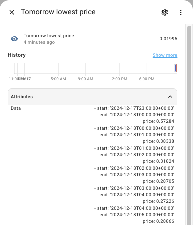

Tomorrow’s lowest price
Using a trigger template, you can create a template sensor to calculate tomorrow’s lowest price which also puts the list of all prices in the attributes of the sensor. All prices are returned in [Currency]/MWh.
Note
Below example will convert the action call response to kWh prices in the selected currency and add all prices for tomorrow as a list in an attribute.
Tip
You can get your config_entry by using actions within the developer tools: use one of the Nord Pool actions and view the YAML.
template:
  - trigger:
      - trigger: time_pattern
        minutes: /10
      - trigger: homeassistant
        event: start
    action:
      - action: nordpool.get_prices_for_date
          config_entry: 01JEDAR1YEHJ6DZ376MP24MRDG
          date: "{{ now().date() + timedelta(days=1) }}"
          areas: SE3
          currency: SEK
        response_variable: tomorrow_price
    sensor:
      - name: Tomorrow lowest price
        unique_id: se3_tomorrow_low_price
        state: >
          {% set data = namespace(prices=[]) %}
          {% for state in tomorrow_price['SE3'] %}
            {% set data.prices = data.prices + [(state.price / 1000)] %}
          {% endfor %}
          {{min(data.prices)}}
        attributes:
          data: >
              {% set data.prices = data.prices + [{'start':state.start, 'end':state.end, 'price': state.price/1000}] %}
            {% endfor %}
            {{data.prices}}
Screenshot: Trigger template: Tomorrow lowest price

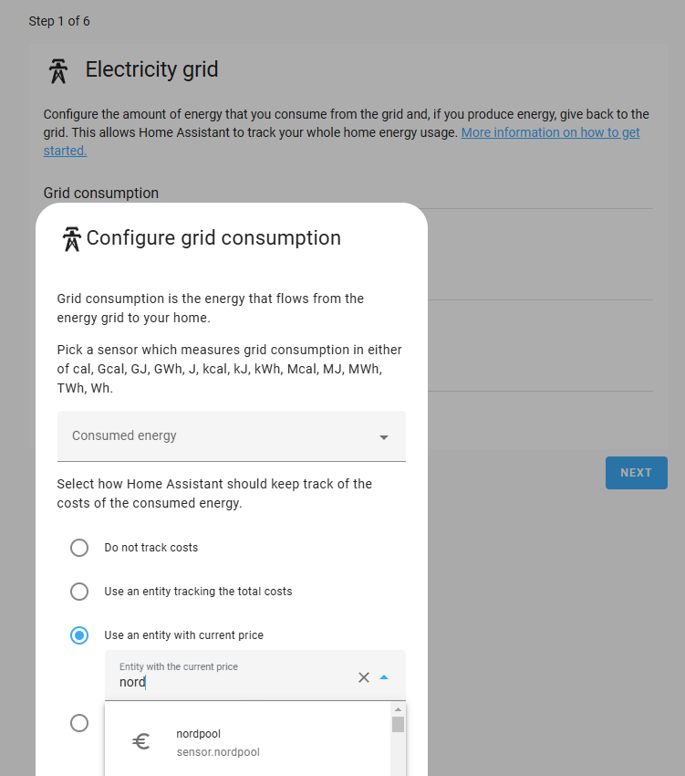

Energy Dashboard
To use the Nordpool integration in the Energy dashboard, when configuring grid consumption and production, use the Use an entity with current price option.
Screenshot: Create template sensor
