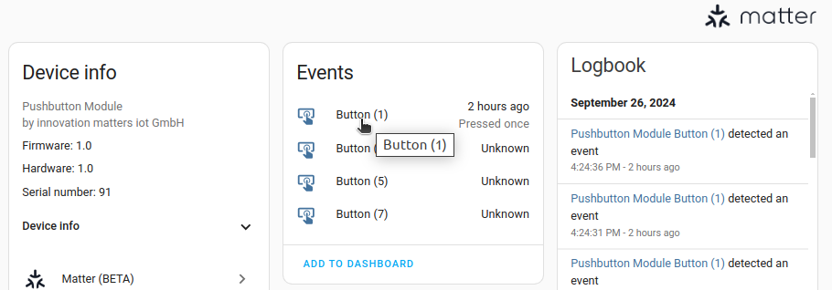

The state of an event entity
The event entity does not capture a state such as on
or off
. Instead, an event entity keeps track of the timestamp when the emitted event has last been detected.
Event entity with a timestamp value in state and event type "pressed".

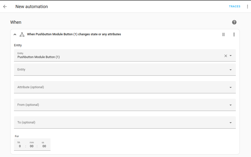

Because the state of an event entity in Home Assistant is a timestamp, it means we can use it in our automations. For example:
trigger:
- platform: state
entity_id: event.doorbell
action:
- service: notify.frenck
message: "Ding Dong! Someone is at the door!"

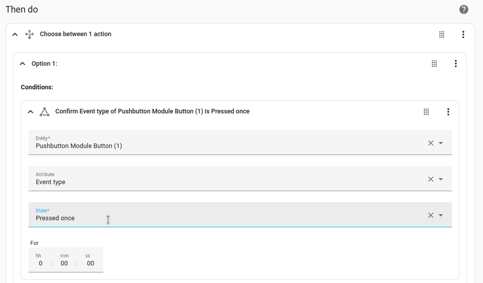

Besides the timestamp of the last event, the event entity also keeps track of the event type that has last been emitted. This can be used in automations to trigger different actions based on the type of event.
This allows you, for example, to trigger a different action when the button on a remote control is pressed once or twice, if your remote control is capable of emitting these different types of events.
When combining that with the choose action script, you can assign multiple different actions to a single event entity. In the following example, short- or long-pressing the button on the remote will trigger a different scene:
trigger:
- platform: state
entity_id: event.hue_remote_control
action:
- alias: "Choose an action based on the type of event"
choose:
- conditions:
- alias: "Normal evening scene if the button was pressed"
condition: state
entity_id: event.hue_remote_control_on_button
attribute: "event_type"
state: "short_release"
sequence:
- scene: scene.living_room_evening
- conditions:
- alias: "Scene for watching a movie if the button was long-pressed"
condition: state
state: "long_release"
sequence:
- scene: scene.living_room_movie
When creating automations in the automation editor in the UI, the event types are available as a dropdown list, depending on the event entity you are using. This means you don’t have to remember the different event types and can easily select them.
