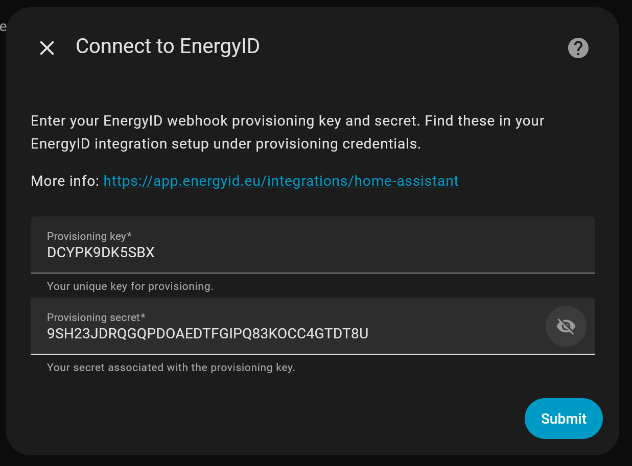

During the setup, you will be prompted for the following information:
Provisioning Key
The Provisioning Key obtained from your EnergyID portal.
Provisioning Secret
The Provisioning Secret associated with your key, obtained from your EnergyID portal.
Initial setup steps
  1. After adding the integration, you will first be asked to enter your Provisioning Key and Secret.
    Screenshot of the EnergyID connection screen in Home Assistant, asking for Provisioning Key and Secret.
  2. If this is the first time you are connecting this Home Assistant instance, you will be directed to the EnergyID website to claim your device. This step links your Home Assistant instance to a specific record (e.g., your house) in your EnergyID account.
  3. Once claimed, the setup will automatically complete.

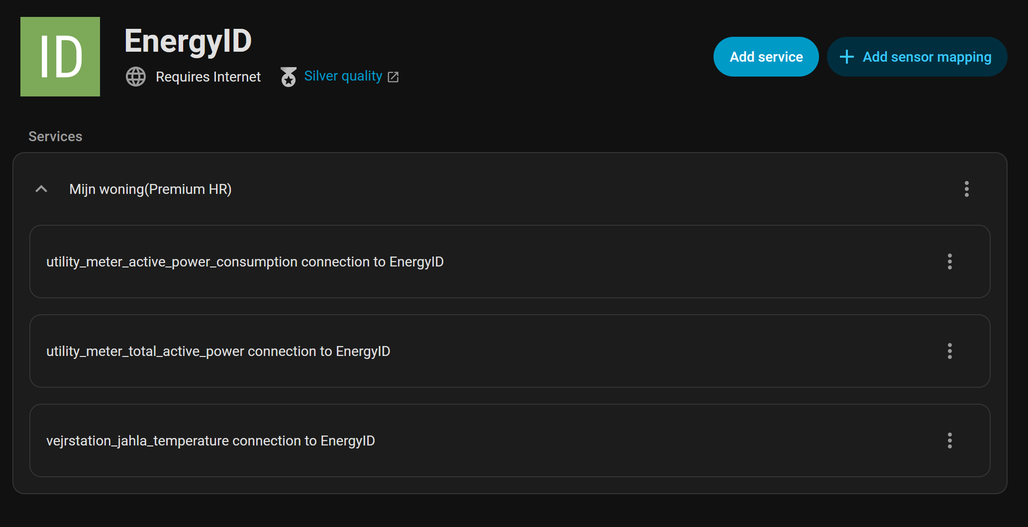

Managing sensor mappings
After the initial setup, you can manage which Home Assistant sensors send data to EnergyID.
  1. Go to Settings > Devices & services.
  2. Find the EnergyID integration and select Configure.
From here, you can add new sensor mappings. When adding a mapping, you will be asked for the following:
Select the sensor entity from your Home Assistant instance whose data you want to send. The list is automatically filtered to suggest suitable numeric sensors.
Screenshot of the EnergyID configuration screen in Home Assistant, showing options to add and manage sensor mappings.
When you select a sensor, its object_id (the part of the entity ID after the dot) will be used as the EnergyID Metric Key. For example, mapping sensor.total_active_power will send data to EnergyID with the key total_active_power.
