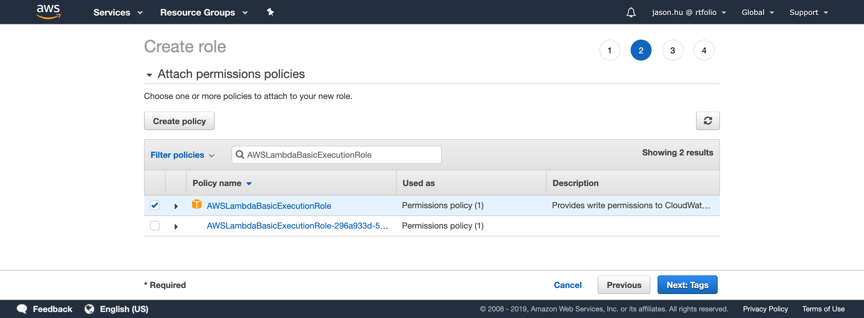

  • Click Roles in the left panel, then click Create role, select AWS Service -> Lambda in the first page of the wizard, then click Next: Permissions
  • Select AWSLambdaBasicExecutionRole policy, then click Next: Tags. (Tips: you can use the search box to filter the policy)
Screenshot: Attach permission policy to IAM role
  • Give your new role a name, such as AWSLambdaBasicExecutionRole-SmartHome, then click the Create role button at the bottom of the page. You should be able to find your new role in the roles list now.
