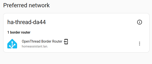

To make Home Assistant your first Thread network
  1. To enable Thread support on your Home Assistant Yellow or Connect ZBT-1, you need to install the OpenThread Border Router add-on. Follow the corresponding procedure:
  2. Make sure the Home Assistant Thread network is defined as preferred network.
    • This should happen automatically, but check to be sure.
    • Go to Settings > Devices & Services, select the Thread integration.
    • Then, select Configure.
    • You should see the Home Assistant logo under Preferred network.

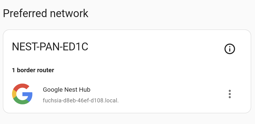

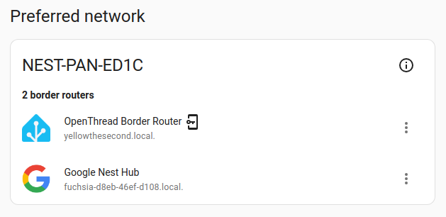

Case 2: Creating a HA border router when there is an existing network
Follow these steps if you want to turn Home Assistant into a Thread border router using the Thread radio of Yellow, Connect ZBT-1, or another compatible radio but you already have third-party Thread networks present. These steps will join the Home Assistant Thread border router with the existing Thread network.
If you have both Google and Apple Thread networks present, decide which one you would like add the Home Assistant border router to.
Prerequisites
  • Device with a Thread-capable radio, such as Home Assistant Yellow, Connect ZBT-1, or another compatible radio
  • Third-party Thread network listed
  • Android phone if you have a Google Thread network, iPhone if you have an Apple Thread network
To create a HA border router when there is an existing network
Note: the steps and images here show the process with a Google Thread network. But the process is very similar if you have an Apple Thread network with an iPhone.
  1. Make sure you have an Android/iPhone phone and your phone is in the same Wi-Fi network as your Google border router.
  2. First you need to import the Thread credentials of your Google thread network.
    • In the companion app, go to Settings > Devices & Services, select the Thread integration.
    • Then, select Configure and Import Credentials.
    • Result: You should see a notification that the credentials are imported.
  3. Refresh the screen.
    • You should now see an icon, indicating that Home Assistant now has the credentials of that network.
  4. Select Make preferred network.
    • Result: The selected network now shows as the preferred network.
  5. To enable Thread support on your Home Assistant Yellow or Connect ZBT-1, you need to install the OpenThread Border Router add-on. Follow the corresponding procedure:
    • 🎉 You successfully created a Home Assistant Thread network and joined it with a pre-existing third-party network.

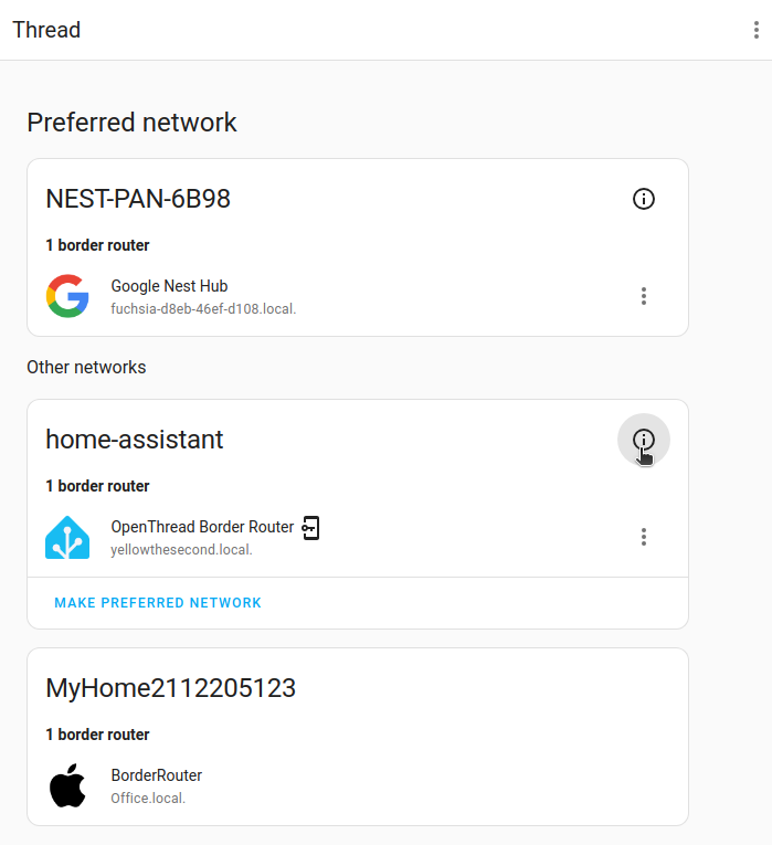

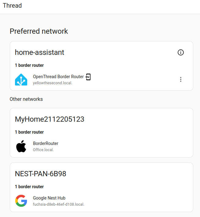

About different Thread networks
Today, each vendor forms their own Thread network when you start using their products. This means you can end up having a Home Assistant, an Apple, and a Google Thread network in your home. The Thread configuration panel lists all Thread border routers and groups them by the Thread network.
The Thread configuration page shows three vendor-specific Thread networks.
These are all separate networks using different credentials. This means devices can’t roam between the Thread networks.
The icon indicates that Home Assistant has the credentials for that network. In this case, only the credentials of the home assistant network are known.
Home Assistant discovers all Thread border routers in your network because they send mDNS/DNS-SD announcements. These local announcements don’t contain the network credentials. That’s why you see the network there, but not the credentials.

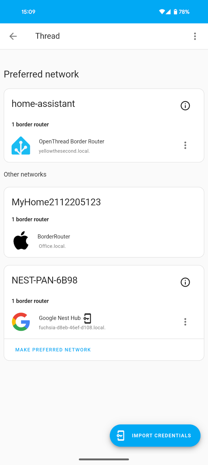

Making a network your preferred network
You can only set a Thread network as preferred if the credentials are known.
  1. To import Thread credentials, you need your Android and iOS companion app.
  2. On your companion app, navigate to the Thread configuration page.
    • You should see an Import credentials button in the lower right corner.
    • Importing the credentials allows a Google- or Apple-created Thread network to be the preferred network of Home Assistant.
