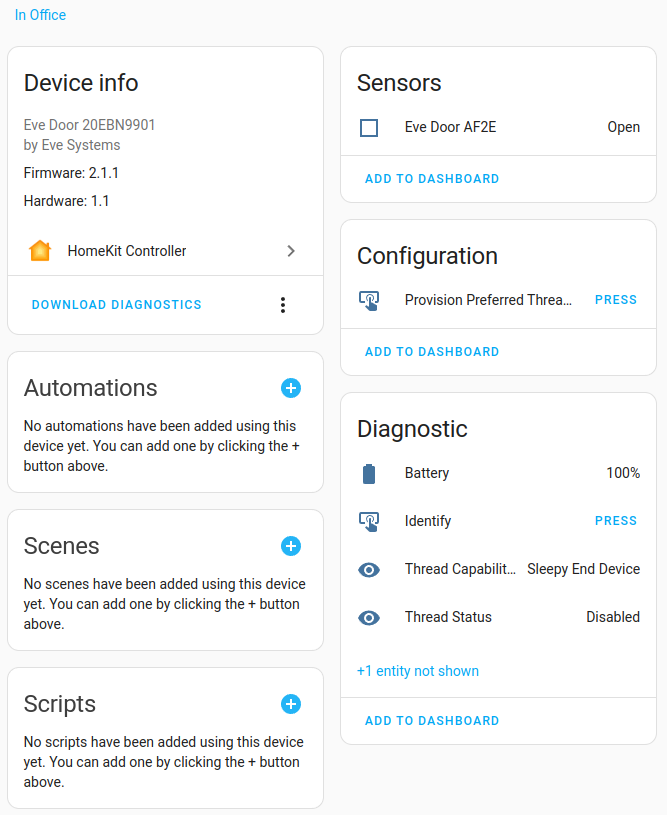

To add a HomeKit device to a Thread network via Home Assistant
- To open the device configuration page, on the HomeKit integration, select the device.
- Under Diagnostic, you can see the Thread Status as Disabled.
- To enable Thread, under Configuration, select Press. This will provision the preferred Thread credentials.
- The status has now changed:
- Depending on the device type, the mesh size and health, the Thread status can be Child, Router, or Leader.
- That’s it. Your HomeKit device now communicates via Thread.
