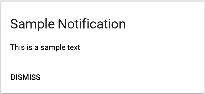

Persistent Notification
The Persistent Notification integrationIntegrations connect and integrate Home Assistant with your devices, services, and more. [Learn more] can be used to show a notification on the frontend that has to be dismissed by the user.
