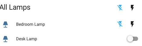

Because LimitlessLED lights may have an obsolete state, Home Assistant shows the power switch as two buttons rather than a toggle. This ensures that the power can be set with a single click even if the assumed state is wrong. You can change to use the power toggle with Customize:
homeassistant:
customize_domain:
light:
assumed_state: false
