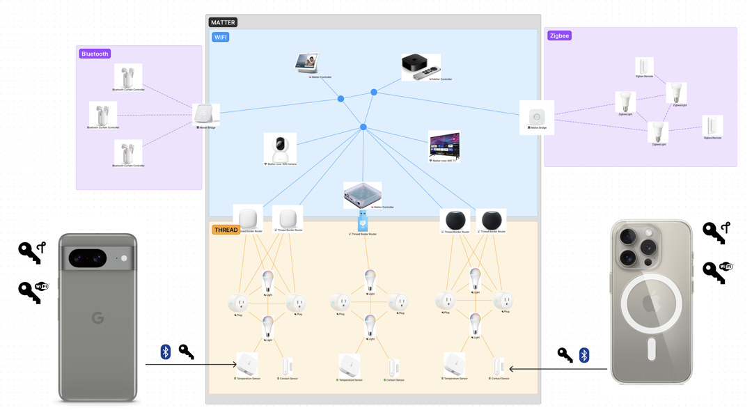

Demystifying Matter
To really understand what we’re talking about when it comes to Matter, we recommend you read our updated Matter documentation or watch this chapter from our live stream.
In this segment, our product manager JLo explains Matter in an easy-to-understand, visual manner, using the diagram you see above. You’ll no longer have to wonder about Thread, Border routers, Bridges, or other Matter terminology after you’ve watched this video.

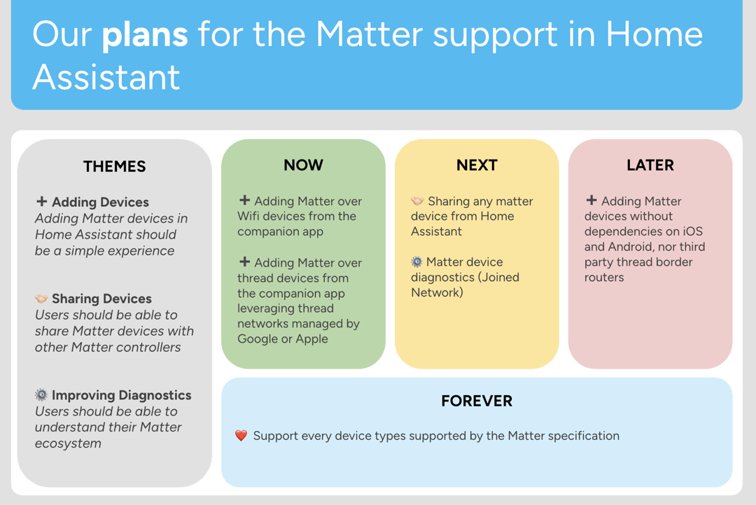

The Future of Matter in Home Assistant
In the near future, we are focusing on improving the user experience to onboard and manage Matter devices. Especially adding new Matter devices to Home Assistant should be as stress-free as possible.
This is what we are focusing on now:
- Functionality to ‘share’ a device from Home Assistant to another Matter controller.
- Showing basic device information and diagnostics about a device in the Home Assistant interface, as well as adding some troubleshooting options such as forcing a full interview.
This is what we will be focusing on next:
- A simpler flow to add Matter devices (a process called commissioning), where we guide our users step-by-step all the way from unboxing a device to being able to control it in Home Assistant. For now, we are focusing on the stable scenarios we mentioned previously. This means that we are improving the commissioning flow in our companion apps, relying on the Matter functionality built into your phone, and using (if necessary) Thread networks managed by the vendor of your phone (Google or Apple).
- A better handling of sharing of devices between controllers (a functionality called multi-admin). Adding a brand new Matter device (commissioning) and sharing a device that is already controlled by a Matter controller (multi-admin) are not part of the same flow. This difference is dictated by the Matter standard and its security features; a current controller (admin) has to allow a device to join another controller. This is often misunderstood today, and we are trying to create a better flow that guides our users toward the right path for their devices.
- We want to implement some missing features in the current platforms, such as light transitions and scenes.
This is what we want to achieve in the long run:
- The ability to use the Home Assistant SkyConnect or Home Assistant Yellow as a Thread border router to connect to Thread-based Matter devices instead of using Apple or Google Border routers.
On top of this, we will continuously focus on extending the support for new devices as new device types are added to the specification or existing ones are extended. In some cases, manufacturers even contribute to Home Assistant themselves to ensure a new device type is supported.
We are also continuously keeping the quality of our Matter integration up to the standard of Home Assistant and fixing the most impactful issues our users are facing. For example, right now, we are making sure Matter devices that lose power are handled better in Home Assistant.
