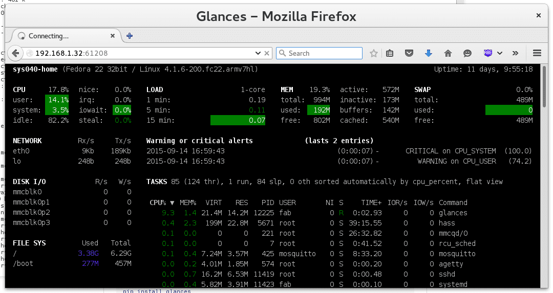

Now browse to http://IP_ADRRESS:61208/. You should see the webified view of Glances.
Glances web interface
