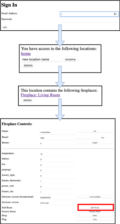

Issue a Soft Reset
There is a debug web interface available at iftapi.net/webaccess. From here you can log in and then navigate to your individual fireplace unit and issue a Soft Reset as follows:
In some cases, this will restore control to the fireplace, but if it doesn’t you are best to try the following method.
Power Cycle
The sure fire way to reset the IFT module is to just power-cycle it. This will work just about every time.
