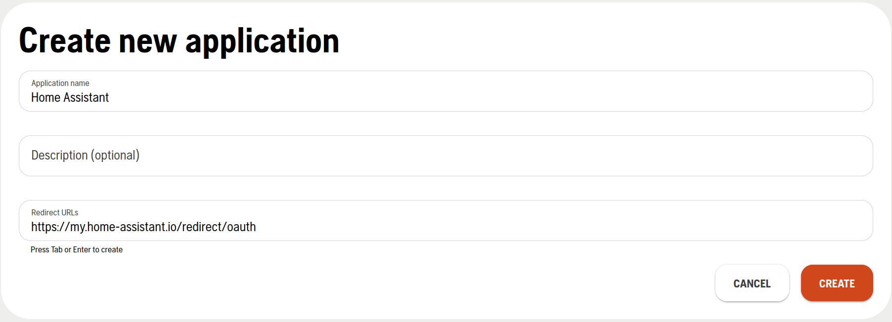

Create a new application:
Name is required but can be anything, for example “My Home Assistant”
Description is optional
Redirect URL:
https://my.home-assistant.io/redirect/oauth
Make sure no extra spaces were appended at end of URL from copy and paste.
- Click CREATE. Application Key and Application Secret will be generated and shown. Protect these like a username and password.

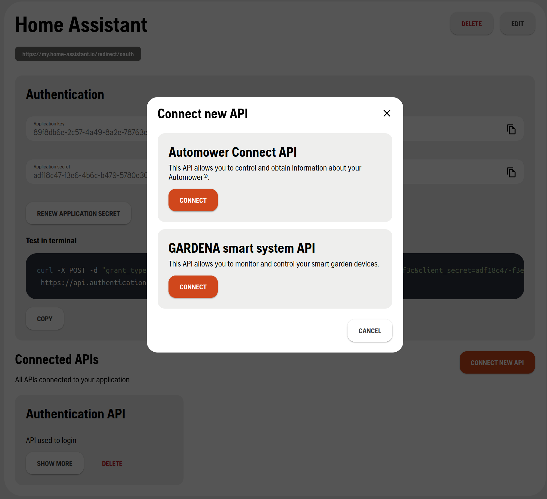

Click on CONNECT NEW API and connect the Authentication API.
Click on CONNECT NEW API again and connect the Automower Connect API.

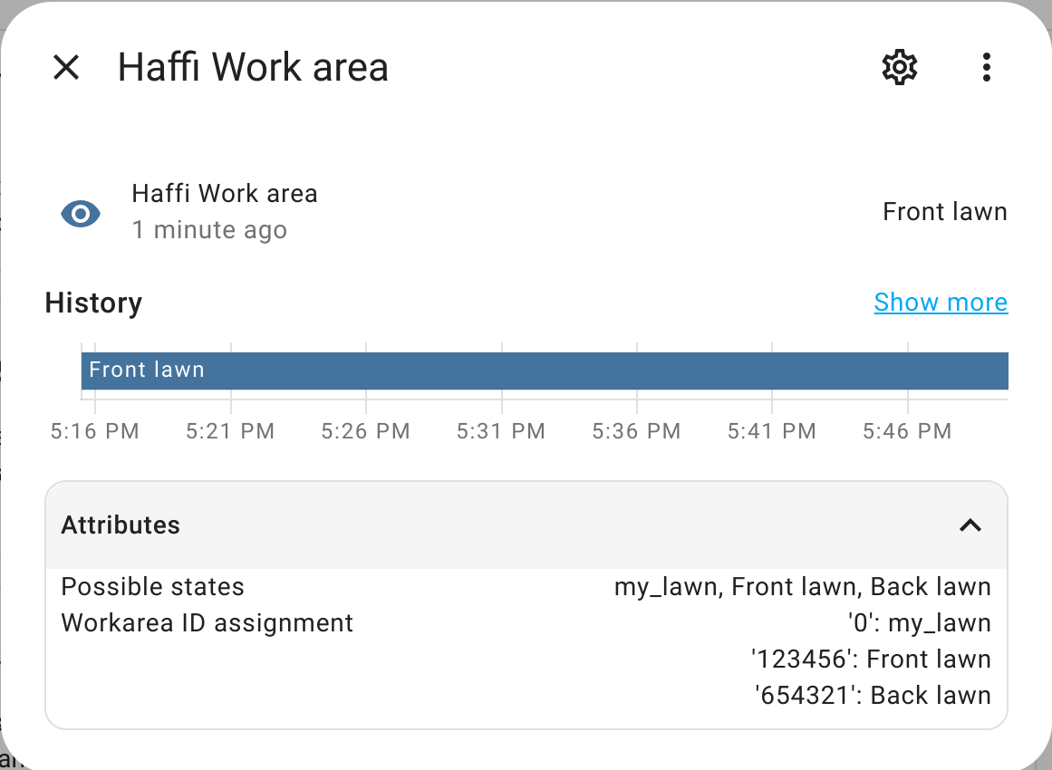

- Work area (if available). For example: My lawn, Front lawn, Back lawn
