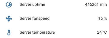

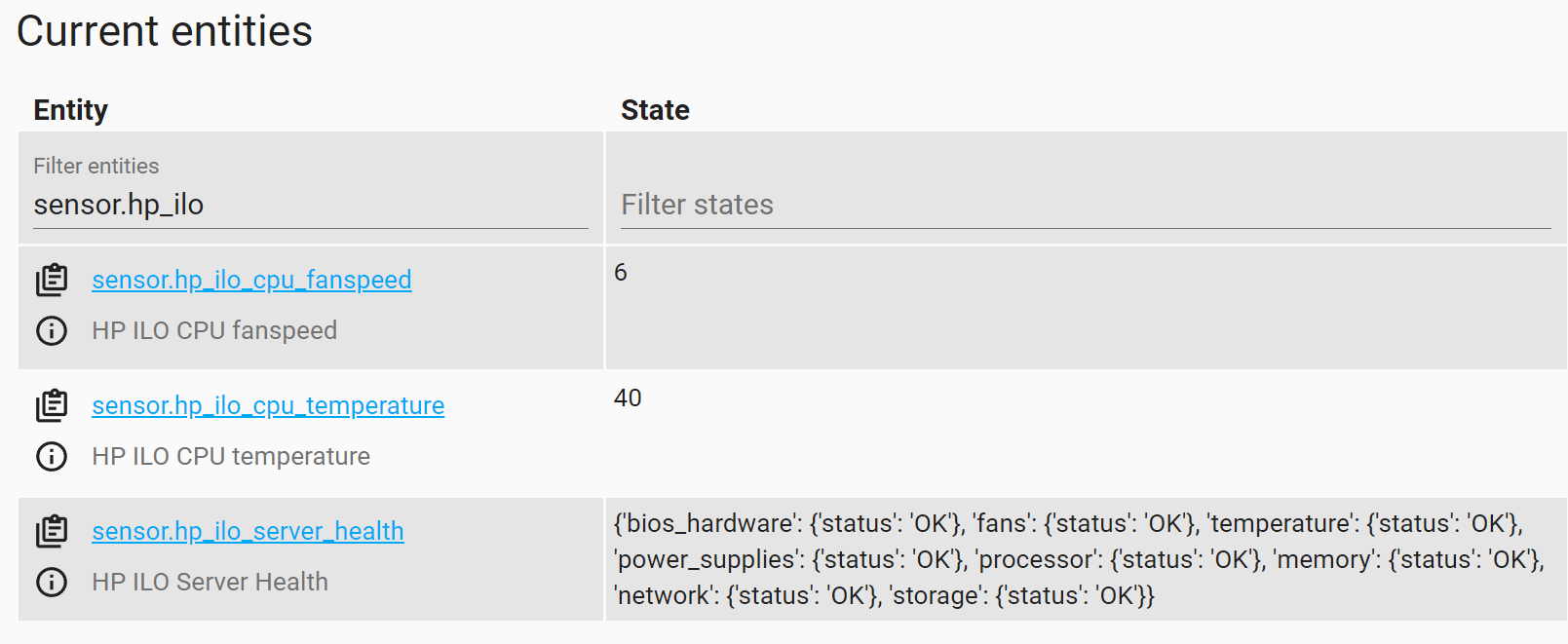

Example
In order to get two sensors reporting CPU fan speed and Ambient Inlet Temperature, as well as a dump of server_health on a HP Microserver Gen8, you could use the following in your configuration.yaml file
sensor:
  - platform: hp_ilo
    host: IP_ADDRESS or HOSTNAME
    username: YOUR_USERNAME
    password: YOUR_PASSWORD
    monitored_variables:
      - name: CPU fanspeed
        sensor_type: server_health
        unit_of_measurement: '%'
        value_template: '{{ ilo_data.fans["Fan 1"].speed[0] }}'
      - name: Inlet temperature
        unit_of_measurement: '°C'
        value_template: '{{ ilo_data.temperature["01-Inlet Ambient"].currentreading[0] }}'
      - name: Server Health
