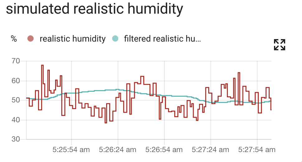

platform enables sensors that process the states of other entities.
filter
applies a signal processing algorithm to a sensor, previous and current states, and generates a new state
given the chosen algorithm. The next image depicts an original sensor and the filter sensor of that same sensor using the History Graph component.
