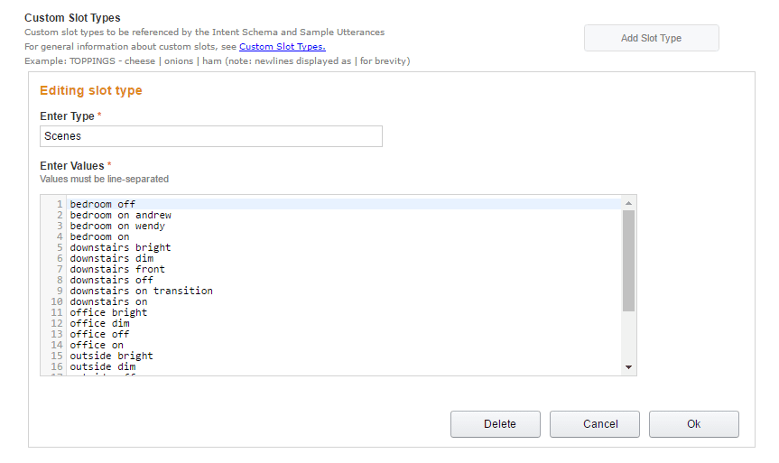

Working With Scenes
One of the most useful applications of Alexa integrations is to call scenes directly. This is easily achieved with some simple setup on the Home Assistant side and by letting Alexa know which scenes you want to run.
First, we will configure Alexa. In the Amazon Interaction module add this to the intent schema:
"intent": "ActivateSceneIntent",
"slots":
"name" : "Scene",
"type" : "Scenes"
Then create a custom slot type called Scenes
listing every scene you want to control:
Custom slot type for scene support.
The names must exactly match the scene names (minus underscores - Amazon discards them anyway and we later map them back in with the template).
In the new Alexa Skills Kit, you can also create synonyms for slot type values, which can be used in place of the base value in utterances. Synonyms will be replaced with their associated slot value in the intent request sent to the Alexa API endpoint, but only if there are not multiple synonym matches. Otherwise, the value of the synonym that was spoken will be used.
Custom slot values with synonyms.

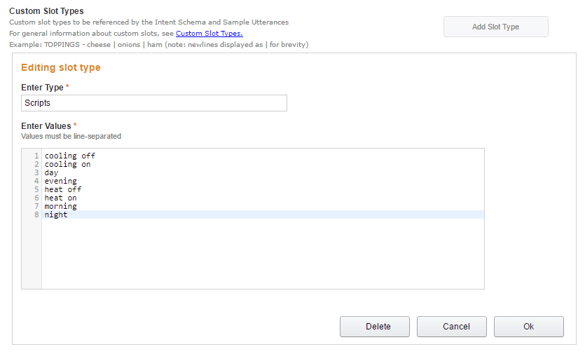

Adding Scripts
We can easily extend the above idea to work with scripts as well. As before, add an intent for scripts:
"intent": "RunScriptIntent",
"slots":
"name" : "Script",
"type" : "Scripts"
Create a custom slot type called Scripts
listing every script you want to run:
Custom slot type for script support.
