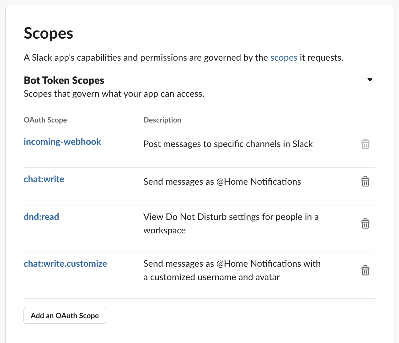

  1. Create a new app under your Slack.com account.
  2. Click the OAuth & Permissions link in the sidebar, under the Features heading.
Find Features/OAuth and Permissions/Scopes/Bot Token Scopes
  1. Add the following OAuth scopes:
  • chat:write
  • dnd:read
  • channels:manage
  • channels:read
  • groups:read
  • groups:write
  • im:read
  • im:write
  • mpim:read
  • mpim:write
  • Optionally add chat:write.customize to modify your Slack bot’s username and icon.

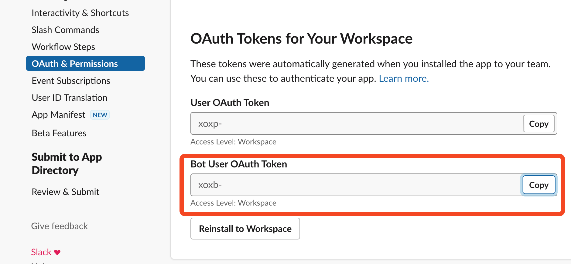

  1. Scroll up to OAuth Tokens & Redirect URLs and click Install to Workspace.
In Features/OAuth and Permissions/OAuth Tokens for Your Workspace:
  1. Copy the Bot User OAuth Token. Use this as ‘API Key’ when setting up in Home Assistant

Sample App Manifest
You can easily create a bot with all the permissions needed from an App Manifest.
display_information:
  name: Home Notifications
features:
  bot_user:
    display_name: Home Notifications
    always_online: false
oauth_config:
  scopes:
    bot:
      - incoming-webhook
      - chat:write
      - dnd:read
      - chat:write.customize
settings:
  org_deploy_enabled: false
  socket_mode_enabled: false
  token_rotation_enabled: false

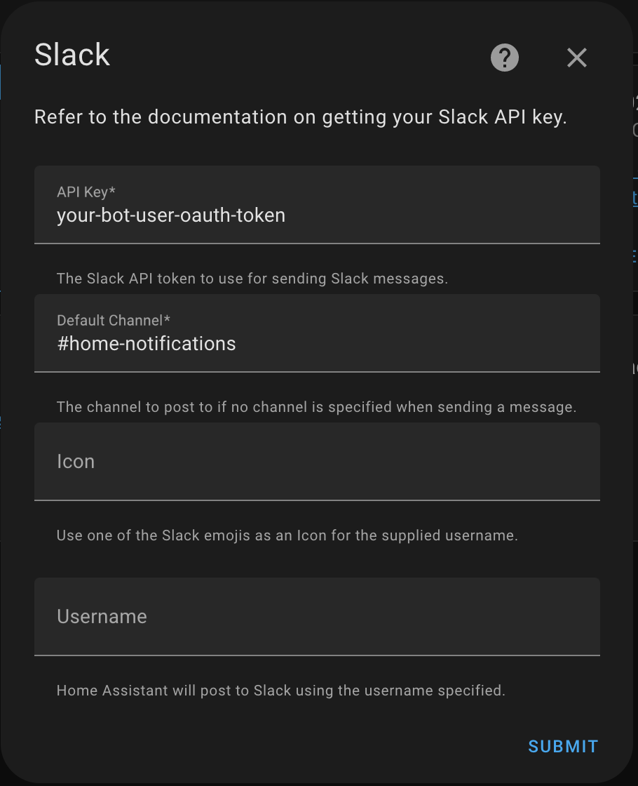

Integration Setup
When installing the integration, use these settings:
API Key: xoxb-abc-def
  • Bot User OAuth Token (from step 5 above)
Default Channel: #channel
  • Channel name that bot will post to if a channel is not supplied when called
Icon/Username:
  • optional - if you want to have a custom name/icon for the bot user not already set in Slack

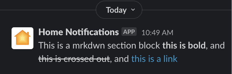

One of the easiest ways to send a message, is to create a script. You can paste in YAML and make changes in the GUI.
You can call this script as an action.
  1. Go to Home Assistant Settings > Automations and Scenes > Scripts > Add Script
  2. Click the three dots in the top right, and pick ‘Edit in YAML’. Paste in the contents below.
  3. Change YOUR_SLACK_TEAM to the team name (*.slack.com)
alias: "Notify: Slack Notification Template"
sequence:
  - action: notify.YOUR_SLACK_TEAM
      message: "Fallback Text"
      target: "#test-channel" # Single channel target
      title: "Reminder"
        blocks:
          - type: section
            text:
              type: mrkdwn
              text: >-
                This is a mrkdwn section block *this is bold*, and ~this is
                crossed out~, and <https://google.com|this is a link>
Update the blocks array with valid Slack blocks. The easiest way to create this is using Slack Block Kit Builder. Up to 50 blocks may be included per message.

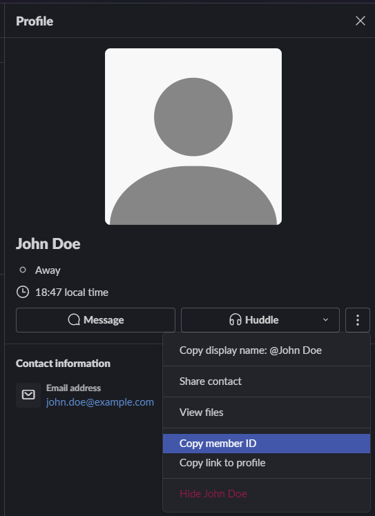

Obtaining a member ID
Some of the examples below use a member ID. This is a unique string assigned by Slack to all users (members and guests) and not a username set by the user. To get a member ID:
  1. Select a Slack user (both name and profile image work) to bring up their profile side panel.
  2. Open the context menu by selecting the three dots.
  3. Select Copy member ID.
