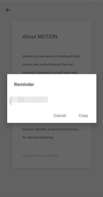

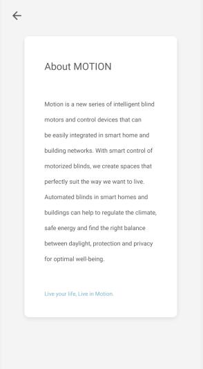

The Motionblinds API uses a 16 character key that can be retrieved from the official âMotionblindsâ app for IOS or Android.
Open the app, click the 3 dots in the top right corner, go to âsettingsâ, go to âMotion APP Aboutâ, Please quickly tap this âMotion APP Aboutâ page 5 times, a popup will appear that gives you the key.
â-â characters need to be included in the key when providing it to Home Assistant. The key needs to be similar to 12ab345c-d67e-8f
