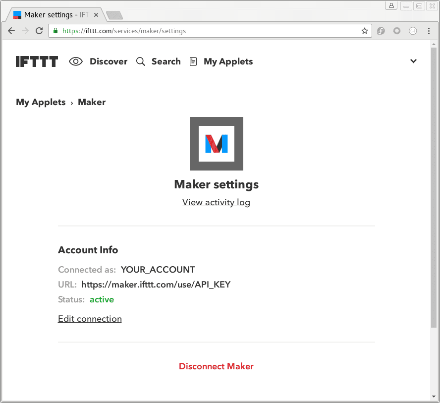

key is your API key which can be obtained by viewing the Settings of the Webhooks applet. It’s the last part of the URL (e.g., https://maker.ifttt.com/use/MYAPIKEY) you will find under My Applets > Webhooks > Settings. Property screen of the Maker Channel.

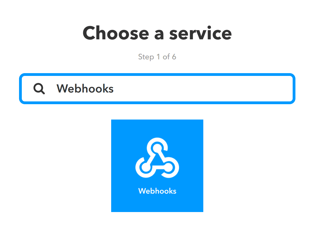

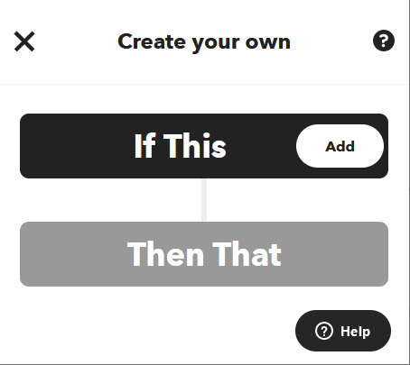

Press the Create button and Add on If This. Search for Webhooks. Create applet.
Choose Webhooks service. Choose “Webhooks” service.

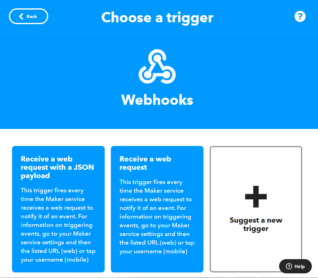

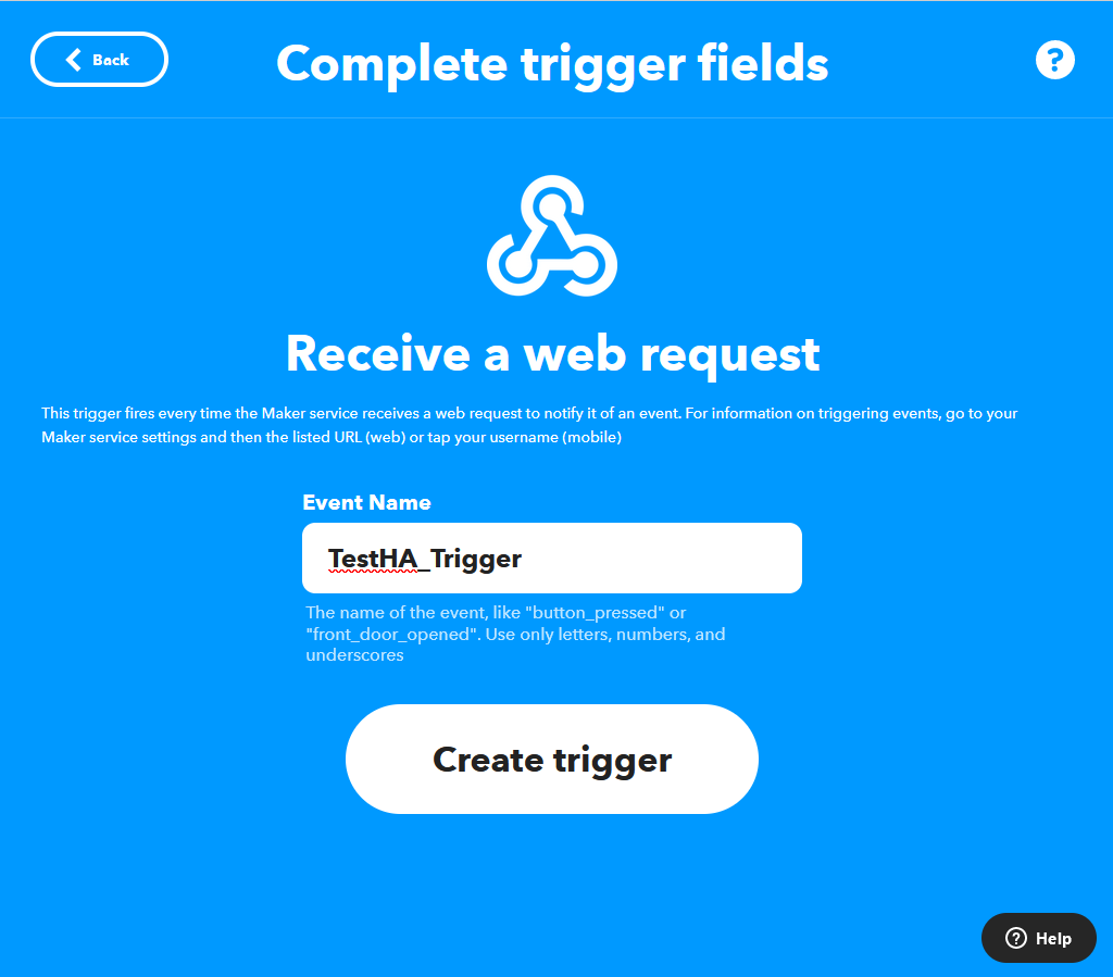

Select Receive a web request. Receive a web request.
You need to set up a unique trigger for each event you sent to IFTTT. You need to set up a unique trigger for each event you sent to IFTTT.
