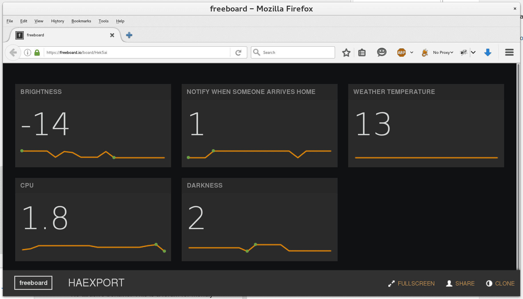

dweet.io
The dweet
integrationIntegrations connect and integrate Home Assistant with your devices, services, and more.
[Learn more] makes it possible to transfer details collected with Home Assistant to Dweet.io
The publishing interval is limited to 1 second. This means that it’s possible to miss fast changes.
There is currently support for the following device types within Home Assistant:
