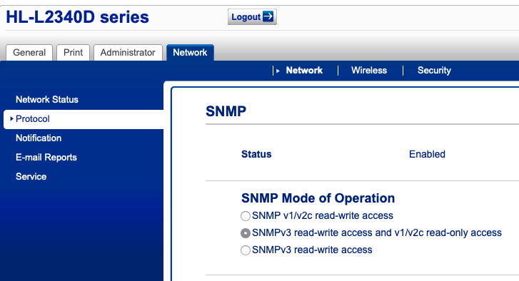

Configuring the printer
To enable SNMP, navigate to the printer’s web interface (for example: http://192.168.5.6
) and turn it on under Network / Protocol / SNMP.
For some Brother devices, SNMPv3 read-write access and v1/v2c read-only access
is the option required (under advanced settings).
