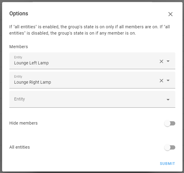

To edit a group, Settings > Devices & services > Helpers. Find and select the group from the list.
Group options
To add or remove entities from an existing group, click on Group options, all the existing entities are listed in the members section where you add and remove entities.
Group attributes
